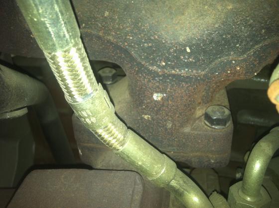

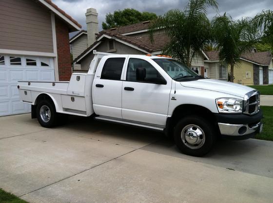

I've never seen empty at 10K GVW more than 1000*(999* maybe) in regen cruising 70 on level roads . I'm not doubting any one else on their temps , but that is what I see on my EGT before the turbo at the Y of the exhaust, pic is before the EGT install. Truck in pic is @ 10K GVW empty.
Nice looking truck. I'm taking it to the dealer on Monday and I'm going to see if there are any PCM updates. I will also pull the probe and test it. Might even replace it. Thanks guys for all the help.

The picture I posted, at the "Y", is where mine is located. Its just before the Turbo so you can see all 6 combining at the same location. It's also easy to get to if you remove the fender curtain and loosen the AC accumulator and drill it with a right angle drill. I would like to see about a setup where you can install an EGT probe at each cylinder. But that is a pipe dream. :-laf
