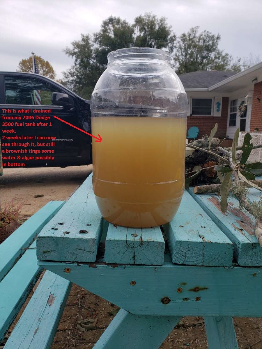

Prior to this past Christmas I had been getting an intermittent water in fuel light, I drained fuel filter, and added fuel Service treatment for water dispersal, WIF light cleared a couple of minutes with all good, this happened 3 or 4 times then no more. Truck started and drove normally for a couple of weeks after the 1st events.
I parked the truck for about 2 weeks, and started it right with no issues; but idling (750 rpm) & moving from parking sport to my carport to do trouble shooting/work the engine was running very rough rough with rattle and hesitation like poor timing, or running out of fuel.
Using the code scan feature of my Edge Insight monitor codes 2269, P0088, P0148, and P0513 were active. and would not clear.
Suspecting water still in fuel separating out after sitting, or algae; I pulled a suction on the tank with a transfer pump I have and pulled out gross fuel; sort of a brown orange you could not see through for over a week of settling in a clear jar. Not much water in the fuel but an orangish tint sort of like rusty gas that had been stored too long in a metal fuel can.
On top of this after the fact ,I found that my fuel level sensor was falsely indicating 1/4 tank as I only drained 4 gallons of fuel from the tank, so I assume I got a bad load of fuel somewhere & the worst of it is what I was trying to run the truck on laying in the bottom of the tank.
Moving forward I cleaned the tank, new float sensor, converted to run an air dog setup, with a Beans sump, and Fleece fuel filter eliminator on. Multiple stops & go on the project, having another vehicle there was no urgency or need to work in the wet & cold of winter, or miss deer season :) .

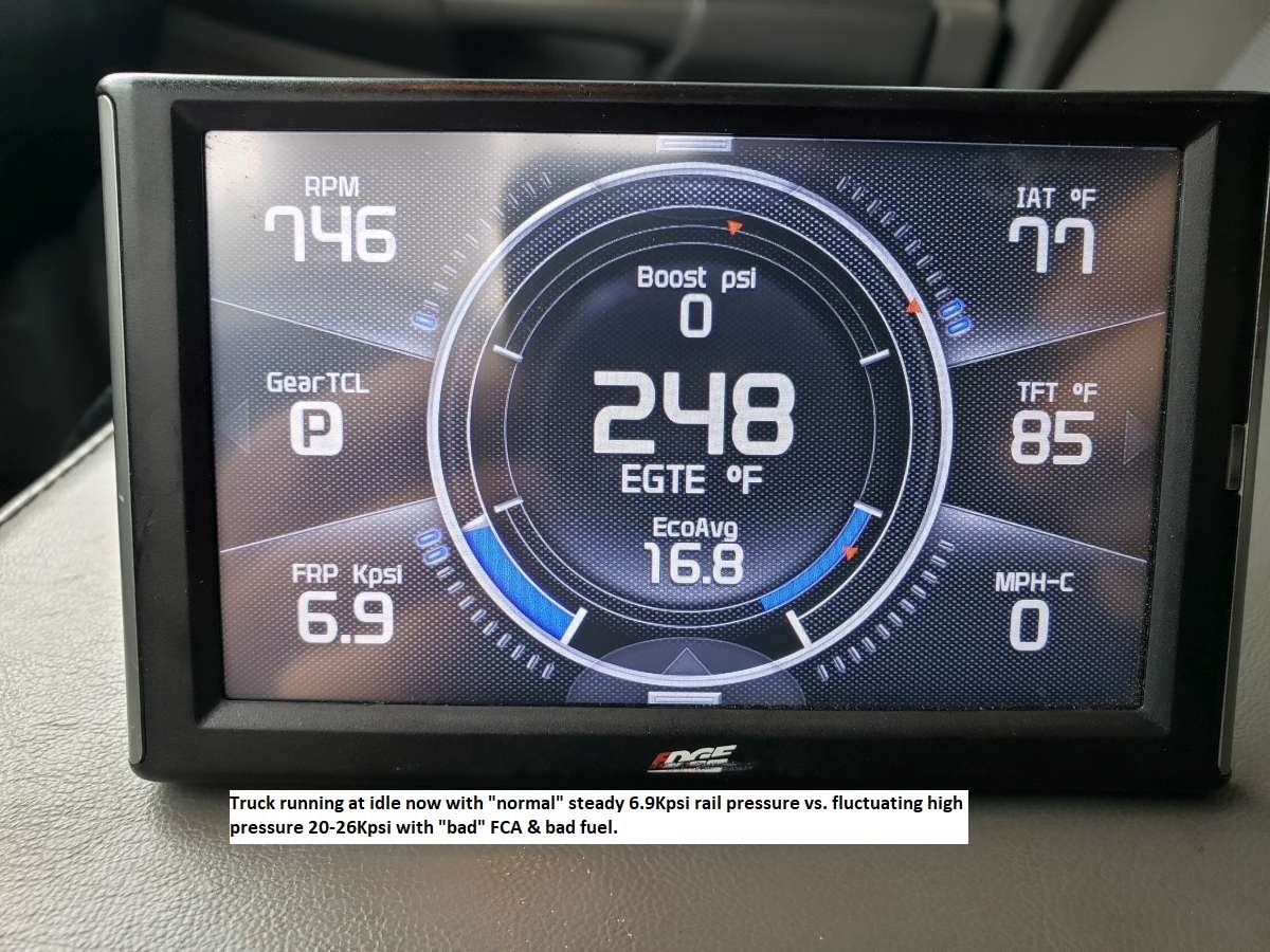

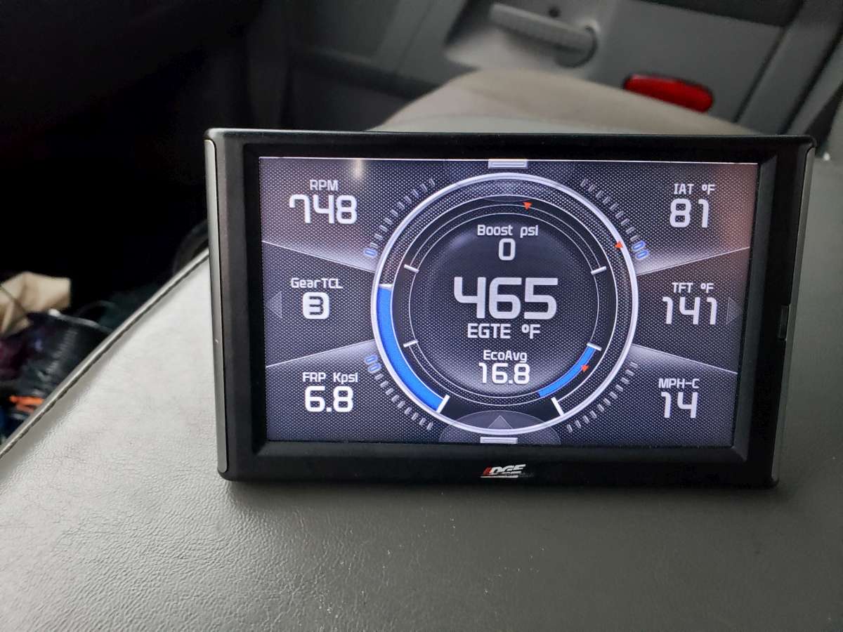

Rouge idle on my Edge 2 monitor I initially indicated 22-26Kpsi rail pressure and the same 4 codes as before.
I shut off truck cleared codes, restarted easily but rail pressure now 20-22Kpsi still at idle 750 rpm, engine will rev but sounds bad holding to the same rail pressure.

Prior to dropping the tank and discovering the crap fuel I had tried to clear the water in fuel via fuel filter replacement, draining bowl and using Hotshot fuel additive, which had limited success as water in fuel light would come on then clear, until finally not coming on again at all.
This was when I was still pretty much driving daily or leaving truck sit for just a few days. As described in 1st post the difference was truck sitting a couple of weeks, and me drawing tank to nearly empty due to faulty fuel level indication.
I suspect what was happening is the treatment had emulsified the water with the fuel and made it within what the engine run without issues/WIF sensor could detect and with truck sitting the suspended water/crud went to the bottom of the tank and then the engine was no longer a happy camper. :(
So now back to square 1 so to speak, clean fuel, dual filtration 30/2 micron now down, all codes cleared except the P0148 code, and crappy idle /high fuel rail pressure. I went through the diagnostics pages found on Genos Garage with respect to HPCR fuel system on the 5.9, I also went through my Cummins engine tech manual and am reading plenty of info for low rail pressure, but only limited information on high rail pressure @ idle.
What I read there sort of points to FCA as next suspect, new one is inbound due in tomorrow, I'll let you know how I make out with that.
One thing I know for sure what was initially drained/cleaned was not what the engine likes to be fed. :)

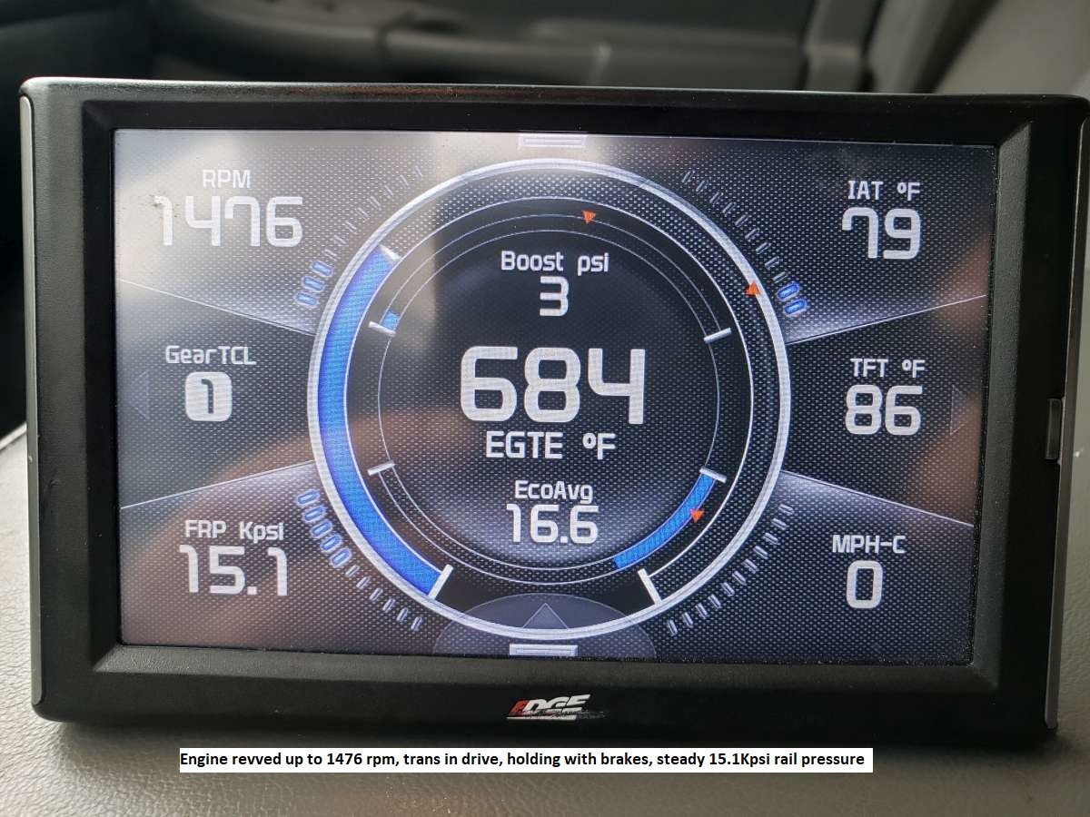

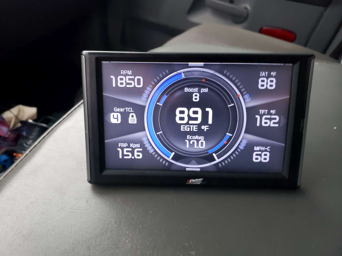

Success or at least looking that way, much improved I still need to go for a test drive.
Thank You all for the remote tech assist. I will update more after test drive.

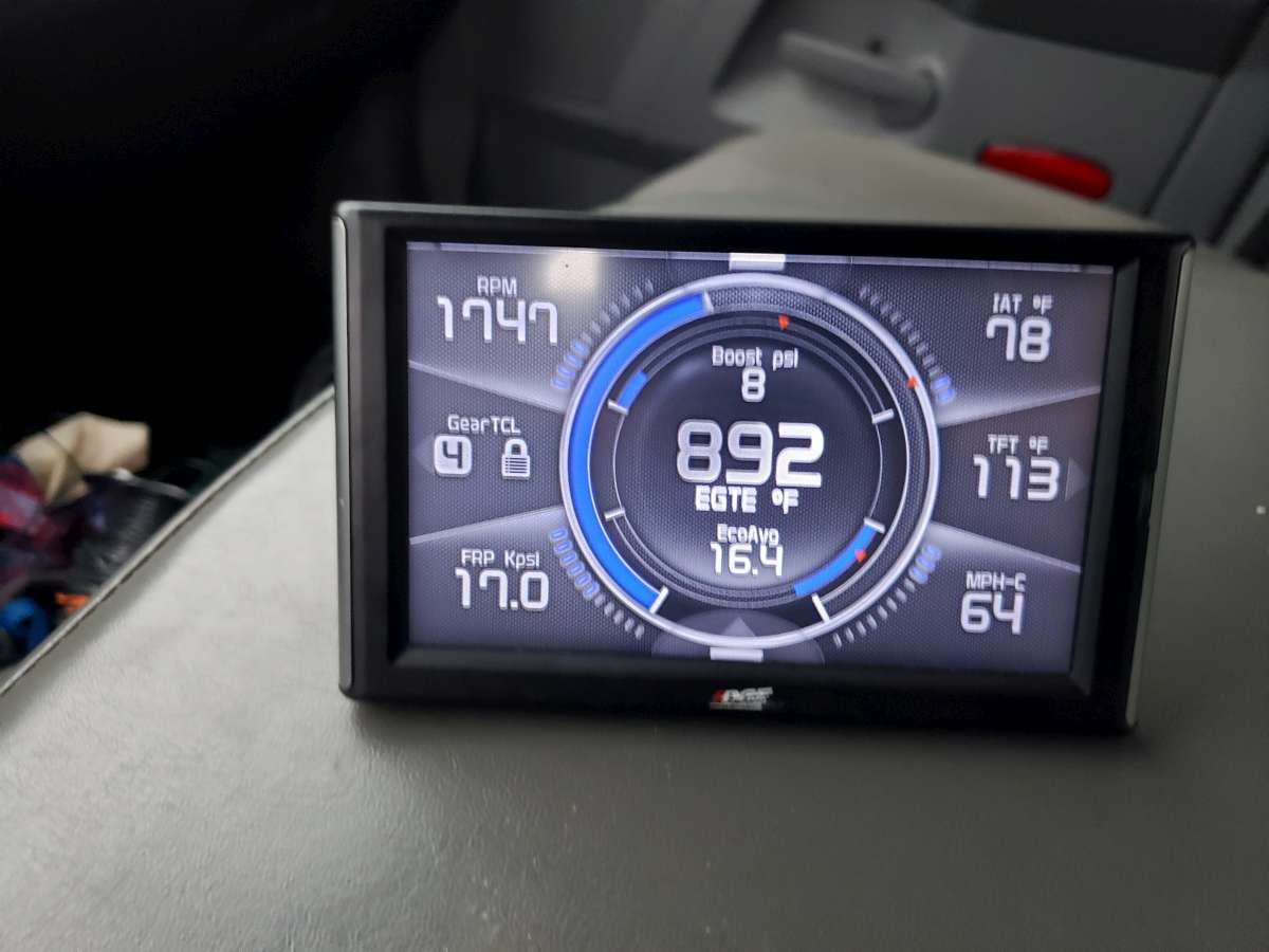

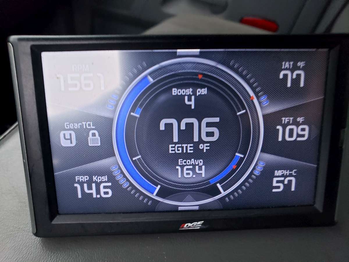

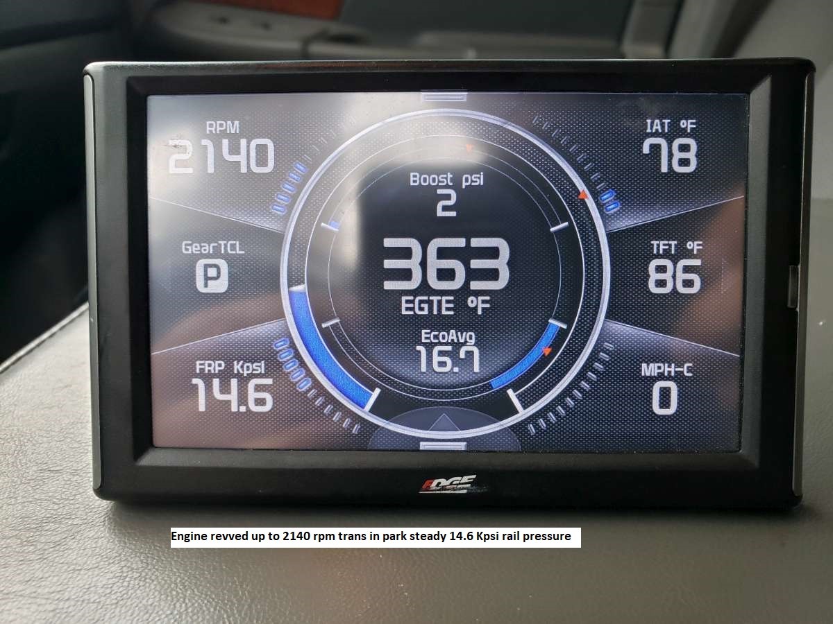

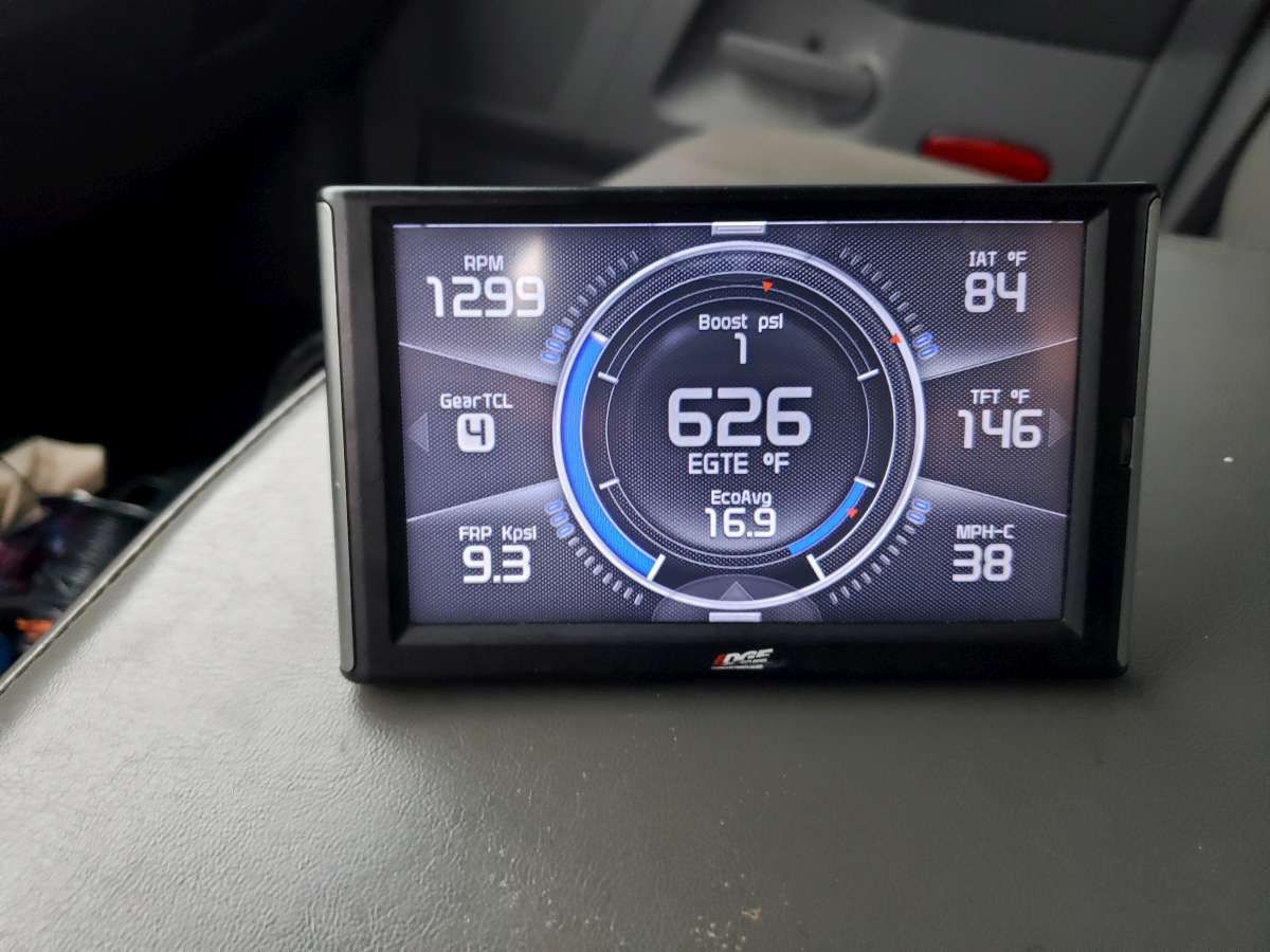

Clean fuel & new FCA was the ticket, no fluctuating rail pressures up to 1476 engine rpm have a look at the attached photos from edge monitor display.

I went on a short road test this evening maybe 5 miles round trip, truck performing as it was before I started having the high rail pressure issue @ idle see attached photos of engine data:
Noted there is a concern with algae in the tank, I think that has been taken care of, tank and fuel system was drained to 0 fuel in system and remained that way for about a month, with exception of any residual fuel in injector feed lines from common rail manifold. Tank was dropped and cleaned as outlined in previous post. Fresh fuel put in tank today, I will treat the new fuel in the tank now; does anyone have a best recommendation for biocide/fuel treatment?
