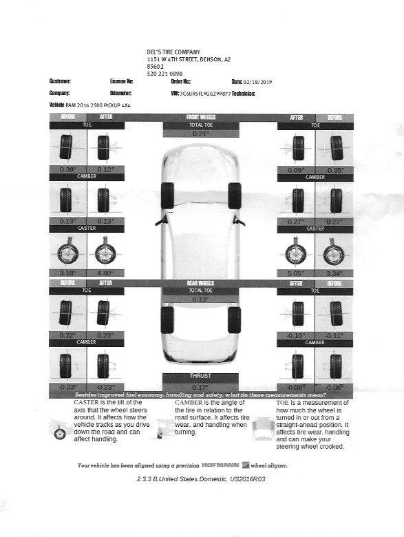

Here is the alignment spec. Strange that they said the left rear can NOT be adjusted?????
Too much toe in , I would stay under 0.05 deg total and you have .21 deg , also too much caster change left to right. Does your truck have a lean to it? I suspect it may due to cross caster, I would keep it at .5 deg more on the passenger side then the drivers.
Looking from the front there seems to be a noticeable amount of toe in and It does seem to lean more towards the passenger side. I appreciate the evaluation. I called the tire shop and their alignment machine is down.
