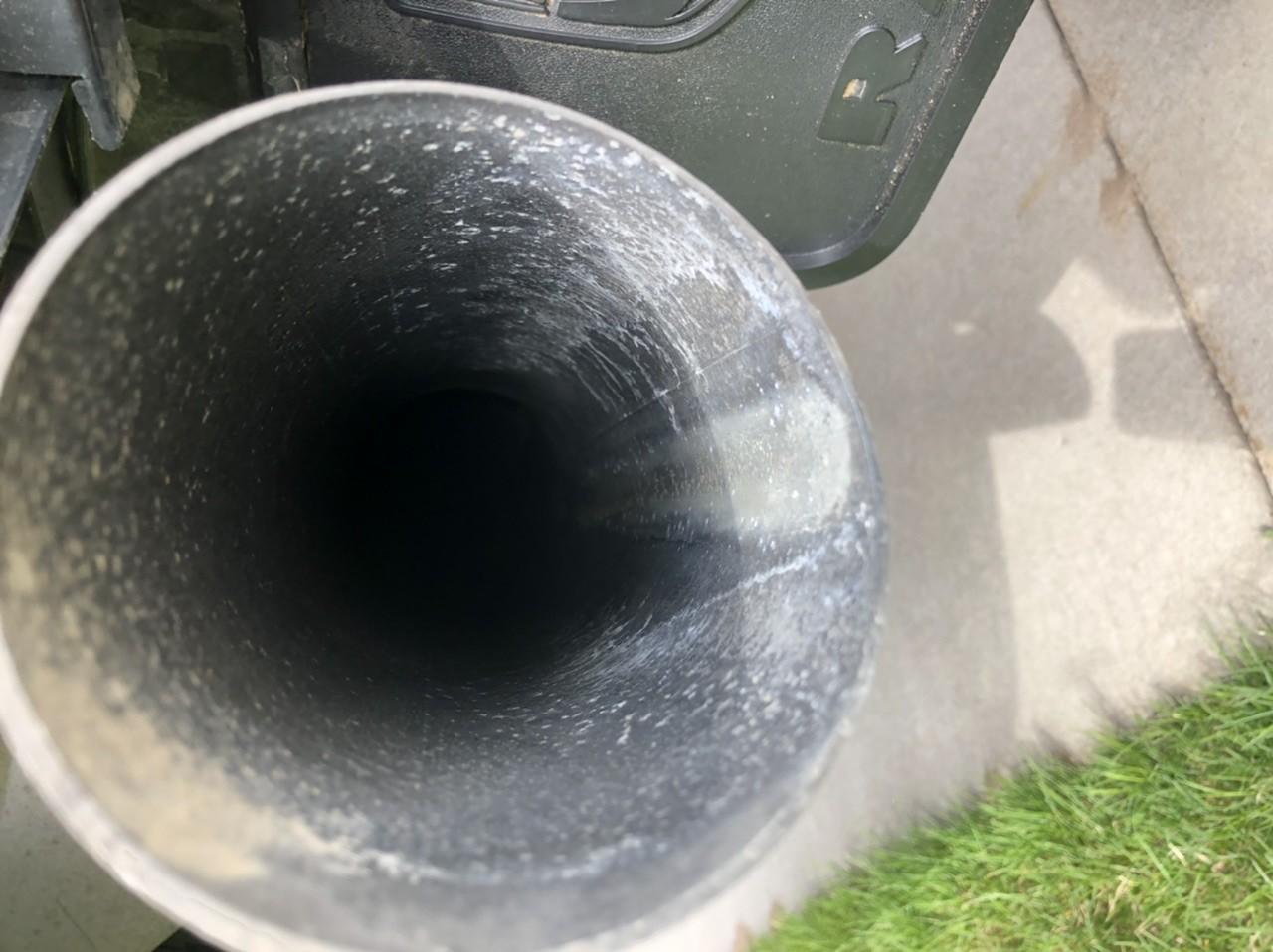

I am glad I asked before taking it in! I am around 11-12 mpg average as most of the time I am pulling a trailer. I have blotches of def on the front of my trailer and I was following my wife recently driving the truck and noticed quite a bit of clear liquid running out the pipe. I also have noticeable white inside my tailpipe and I hear the clicking noise I am told is the def pump clicking very fast quite often.
All seems excessive but if it is normal I’m good with putting in a box every 2.5 tanks of fuel.

No, you have an issue. Tailpipe should not be coated in dry DEF, and none should be blowing out of the pipe.
Sounds like you have a pump or injector sticking issue, it should be turning on the check engine light and posting a code.

Are you sure the stuff coming out the pipe wasn't condensate?
What are you seeing on your trailer? Pics?
I would certainly think if DEF was running out the tail pipe you would have tripped a CEL long ago. These trucks don't have much leeway when it comes to monitored parameters like this.

It sure could be condensate, it’s still chilly up here. The def on my trailer and bed cover could have found it’s way up from a drip hanging underneath after spilling from a truck stop fill station I suppose. It does not do it regularly, but it was the same spider web crusty residue consistent with dried, spilled def.
I have no CEL and it sounds like my mpg is typical.

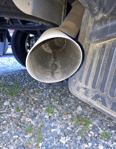

I would suspect condensate, not sure where DEF would actually come from in that volume that far back. My pipe looks similar to yours with the "condensate river" and I only have 5000 miles on it.
