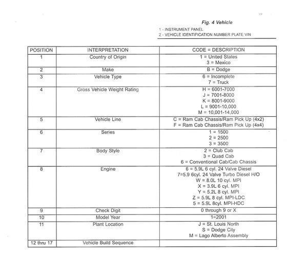

Been around TDR a long time, looking to help a friend with a decision to buy a 02 HO. Give me ALL the good, the bad, and the ugly. What is the main difference between a HO and SO engine? What is the difference between a HO and a SO injection pump? Can a SO pump be put on a HO engine? The truck has a C VIN in the 8th spot any issues with that? Any info or TDR links to older threads would be a huge help. I spent a little time in search area but did find what I was after. Thanks

This is from the 2001 FSM, I would bet the '02 is the same.
