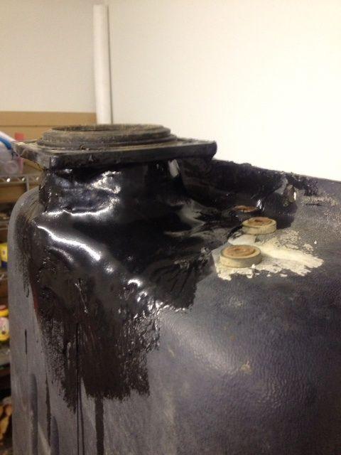

This is the only one I have showing the damage. On the left side you can see where neck and valve assembly was.

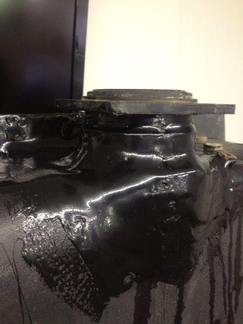

I took the Plasti-mend kit which came with it's own cleaning pad and cleaning solution and cleaned the areas about 4 inches back from the damaged area. The kit comes with fiberglass window screen so I cut several strips so I could layer them around the crack all the way around the neck.
I put a small amount of the plasti-mend around tank side of the crack using it like glue. I then put the broken tank neck back on the tank. I sat about five pound of weight on the top of the neck and let it sit for about thirty mins. (Really however long it took me to change the oil in my truck. ). Next I took the included 2inch paint brush and applied a small amount along crack and then used that to hold the screen material in place. Then I applied a liberal coat over the screen material all around the neck and crack. Instructions claim to wait 1-4 hrs before second coat but I gave it 24hrs as I was doing it in the evenings after work. On one of my tanks I had a flap that didn't fit back in to the crack well so I left it alone till the orginal coat had set up, and then I put a fair amount on the crack side of the flap and took a c-clamp to it to hold in in the correct place. About 6hrs later it was there like it had never been torn off. I came back and put a second coat and a little more screen material as I went further up the neck trying to make sure I had plenty of support since I would be putting pressure on the repaired area every time I opened and closed the tank valve. After 24 more hours the repair was solid.
