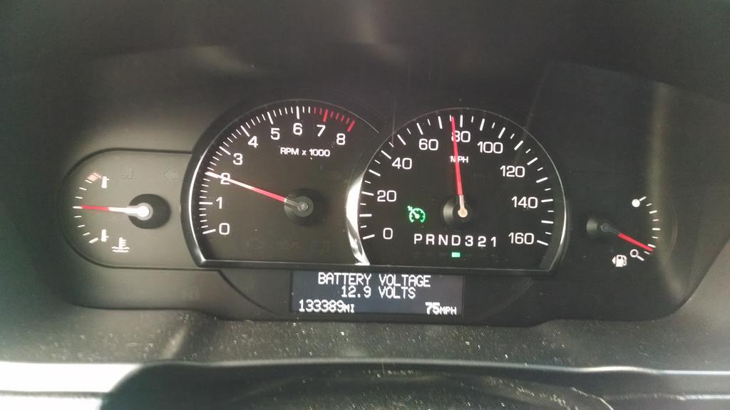

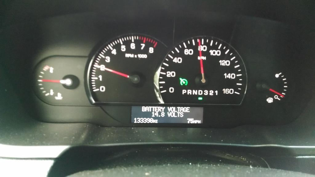

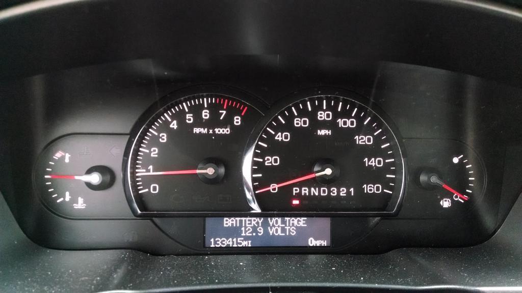

Noticed this last year and 40,000 miles ago. Went right in to a panic, OMG how much is an alternator going to cost, new or reman, how to change it, etc...
I have decided it must be normal. Probably why I changed out the OEM battery last summer at 8 years old.
It seems quite happy at 12.8 volts. When you add a load such as the rear window defroster it slowly ramps the voltage up. Remove the load and it slowly ramps back down. I really think that this is by design.

Interesting.. if you had a battery last 8 years, that is well over typical, so it may well be regulated to switch to a trickle charge, that said it seems unusual for GM.. normally these are internally regulated alternators. It is possible that it lowers output with lower current load, then ramps up for higher current load.. this would also permit rapid charge (higher current demand), then taper off when a battery was fully charged . A good way to look for this.. see what it reads shortly after start up (been sitting for awhile).. the demand to starting cycle and idle time (normal internal and car trickle battery load) should want the higher voltage and thus current to charge that energy back into the battery.. if you still have 12.8 V following sitting time and a start.. I'd say you are having an alternator issue. You'll want to get that energy/charge back, but following that a taper when fully charged will extend battery life if that is what you are seeing - it would be good. Come to think of it.. I do see a similar pattern on my GM car (96 Saturn).. though not as wide a range from 14+ to 12.8V, mine goes lower to about 13.5V after it's been running for some time. That said, I'm on the 3rd alternator, and 3 battery with 190K miles on that car.. If you are on original alternator at 133K you are doing very well!
Oh, if you go with replacing the alternator, as a former parts store employee.. I HIGHLY recommend only NEW units, or get the parts and rebuild your own (Bearings, brushes, Diode, Regulator). I'd estimate that about 1/3 of the reman units we sold came back soon after as defective.. it is not worth the small savings in cost to do the work of the replacement twice, time is worth something!
I had a GM rental car a couple months ago and on a long drive I noticed the same thing. I was in the middle of Yosemite when going up a hill and the voltage went from 14.x to 12.x and thought I was in for some roadside assistance but 40 miles later when I rolled the window down the voltage came back up momentarily.
My 2007 Toyota Tacoma would go into a float after an hour or two but the Dodge never does.
Alright, just put my Marriott rewards into play for free wi-fi, It's all good now...
It will ramp up the voltage to 14.5 when first started, in the summer it takes about 10 miles before it settles down under 13. In the winter with lights, heater, heated seats and other electrical thingies it takes longer but will still drop down to low - mid 13's. But even in the winter once the seats turn down and the blower fan slows it will drop to 12.9 on a long drive.
I think that it is a fairly intelligent voltage management system. Figure that the lighting is all LED inside, tail and brakes lights are LED as well. Headlights are true HID which I suspect draw less power after they initially start. That only leaves two incandescent 4157 turn signal / drl bulbs and a pair of 194A parking lights. It makes sense to me to cut the rate of charge back to the float point. The 8 year old battery would still start the car every day but could not be trusted to set a week.
