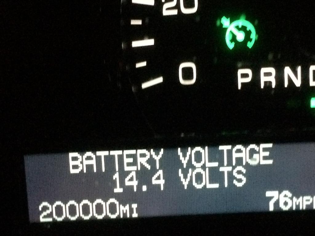

Magic 200,000 rolled up on the odometer coming home last night. This has been the best used car I have ever owned....
Bought it almost 4 years ago with 93,000 miles on the clock, had some issues from neglect of prior owner.......
Averages 22 mpg on a daily commute of 120 miles, higher some other days when I travel to the other locations. Low as 19.5 mpg in sub-zero temps and most of that can be attributed to using the remote start function (twice)...but it's worth it. Highs of 24 mpg during summer running 75 mph on the big road.
Oil usage remains at 1 pint using the suggested oil change of the GM algorithm at 12,000 miles...
Items replaced or repaired....
Front struts, rear shocks (Auto Level), Spark Plugs, Water Pump, Oil Filter adapter gasket, Secondary Air Injection Valve, Both HID headlight bulbs, (2) Batteries (one was a warranty failure) , two sets of tires, C/V shafts (L & R), several front calipers until I learned to only use new GM calipers, rear brake pads, and I believe (3) wheel bearing / hub assemblies....
I call that pretty damn good......for a $7500.00 used car...

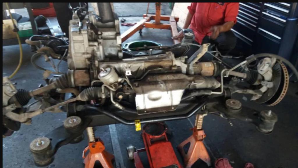

It's labor intensive as the correct way to do it is to remove the cradle. If you have a lift it really isn't that bad.
Some claim to be able to change them in the car BUT if you install head studs (which is the right way to do it) you can't get the rear head on over the studs when in the vehicle...
The cradle is made to come out, just have to adjust your thinking a little...
Can't find a real good shot but these will give you some idea....
Complete cradle assembly less C/V shafts and related stuff

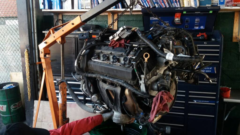

Engine removed from cradle and transmission

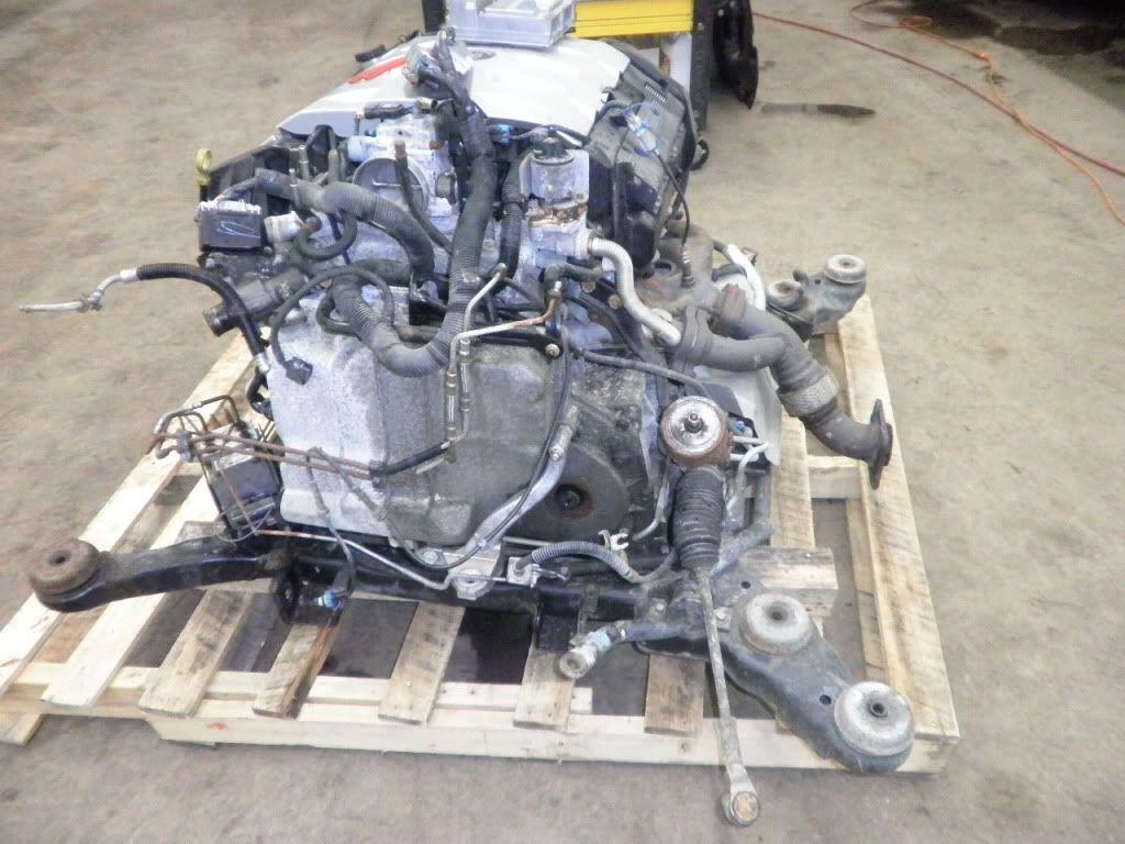

Cradle less engine..
