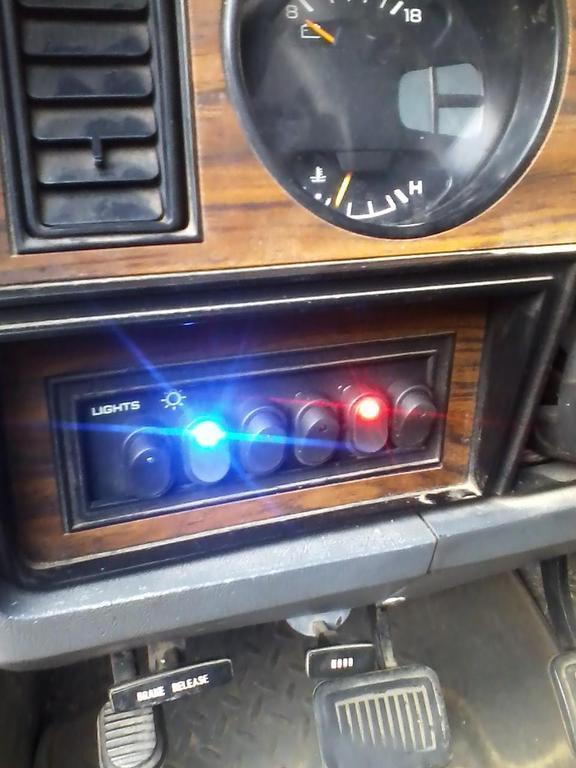

I burned up two factory switches then I got creative and did this.
That's bad ***! I'm kind of a junkie, when it comes to switches and knobs. I have visions of turning my dash into the cockpit from the movie Airplane! I'd like to know what each of those switches operate.
By the way, I tried running the lights with the rheostat at both extremes and different positions today, and sure enough, all the way up is ice cold; Any variation gets it cooking within seconds.
Starting from left to right the switches run the marker lights, head lights, dash lights, fog lights, trailer lights, and finally dome lights.
