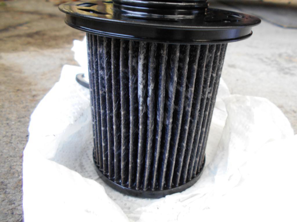

Hey GAmes, is their any product that would help clean the fuel system?Since the truck sat for a long period of time, before I got it from my mom, I think the fuel system may still be contaminated or dirty, even after I have had it for a year. I've been hurt since last December, and have a 10 lb limit, so I can't do much. my wife drives it off and on,and some morning it starts fine and some morning in blows white smoke on start up. I've read when injectors get dirty ,they can cause white smoke on start up. Just trying to keep it running till I heal from back surgery to real look at it. Thanks Dave
How many tanks of fuel have you gone through? Pulling the filter for inspection would be a good indicator of what's in your tank, ie algae, dirt etc. If you pull the filter and it's nasty or you suspect water the only real solution is dropping the tank and cleaning it as well as blowing lines out and cleaning the filter housing.

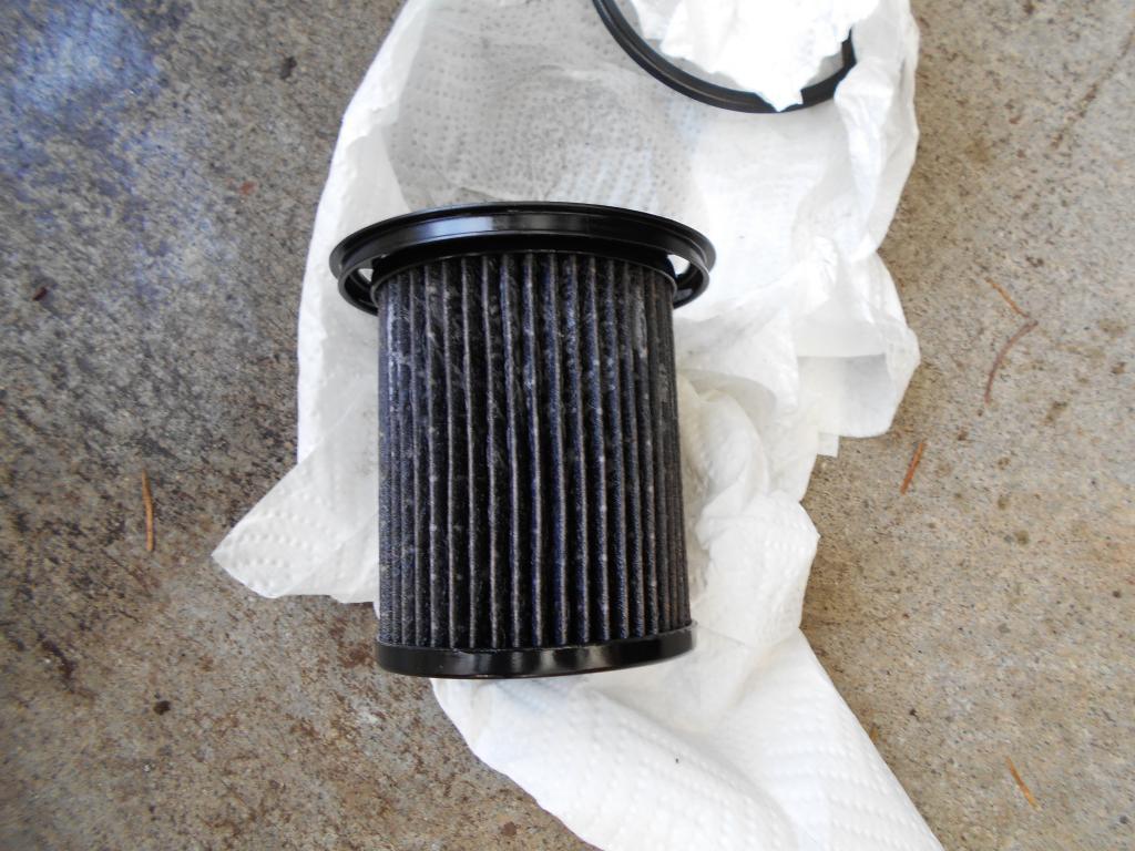

I know when it gets cold diesel react differently in cold weather. whats not making sense is it would do it in warm weather, not all the time,but more if it sat for a week. The truck did get fresh oil and filter on a regular schedule (life time oil and filters changes)even if it sat for a period of time when my mom had it.When I got it, I changed the fuel filter, and it did look odd.It was black and had a gray spots all over it.Once I heal, I'm replacing the return fuel line and pump fuel line (from LarryBS). I 'll just make sure to tell my wife to let the truck warm up before driving it. Thanks guys
That filter looks normal to me. Unless you have an exhaust brake there isn't any "warming up" benefit to letting the truck idle when it is cold. Once the oil pressure comes up driving it will warm it up better.
