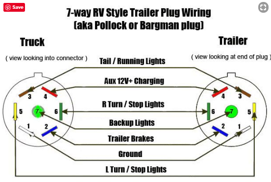

I'm trying to figure out the electrical issue on a 1997 Bigfoot truck camper, I have checked my 7 way plug on the truck at the rear end and in the bed, Both are wired correctly per the truck diagram below. The 7 way extension I have to plug into the camper reads like the trailer plug below when either end is plugged into the 7 way on the truck and the opposite end is read.
when I have the camper plugged into the Truck I'm getting 13.3=14.7 volts to the charging wire at my house batteries. ( I do experience a 0.1 volt drop from the truck to the charge wire. ) If I turn my running lights I get no voltage to the charging wire. I was also having a back feed issue when my running lights were on back through the Backup lights on my truck but not the camper that I know of. So I disconnected the backup wire on one end of the plug. The turn signal and running lights work correctly on the camper.
But I'm still searching for ideas on the charge-line issue. Thinking about switching the auxiliary and running lights wire on one end of the connecting plug and see if that changes anything. Or just gives me no voltage when the lights are off, and constant running lights.
