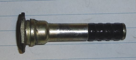

couple of the slide pins are starting to stick, dry out whatever you want to call it.

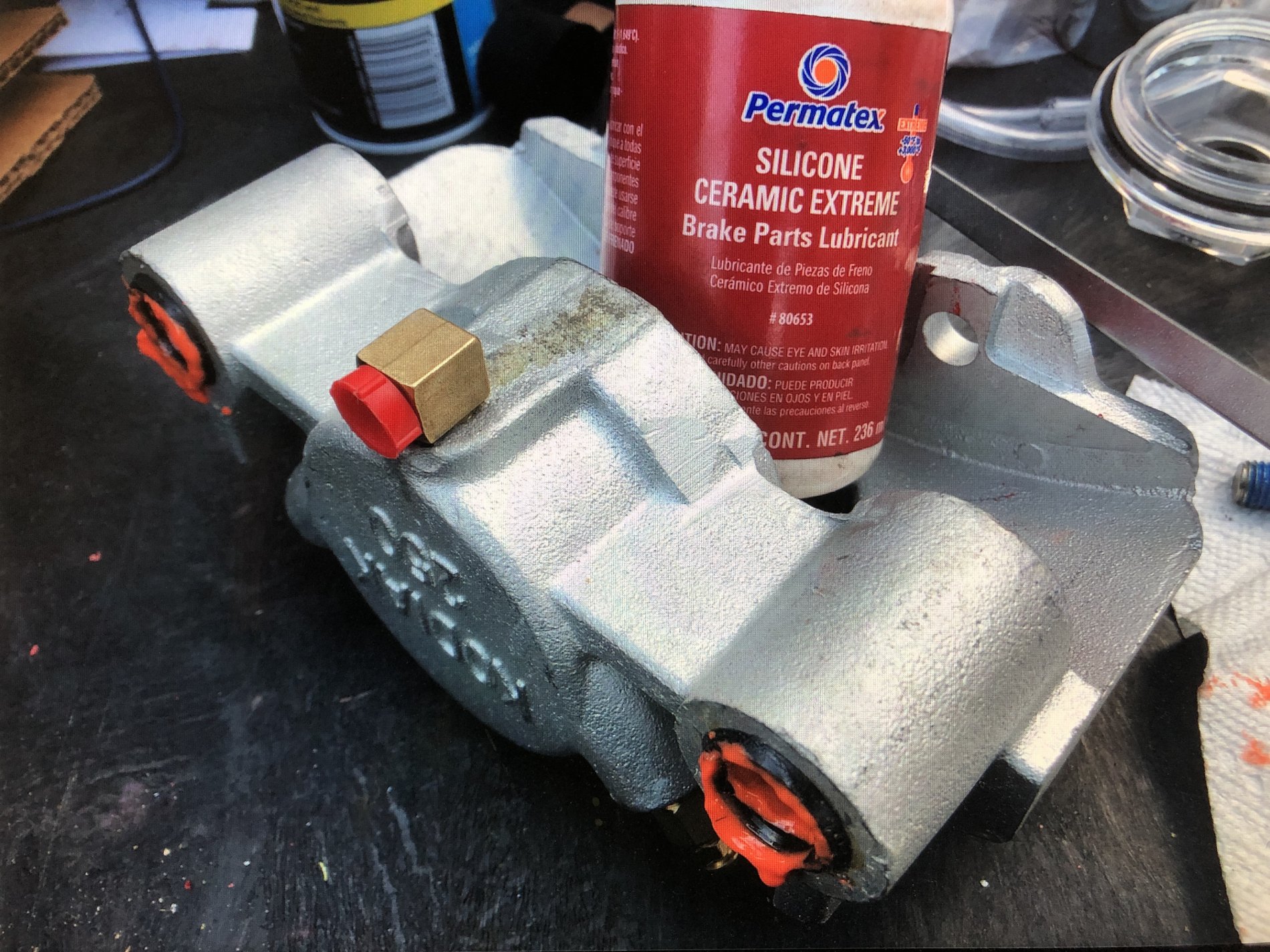

and what should you lube them with?
these guys I am talking about.

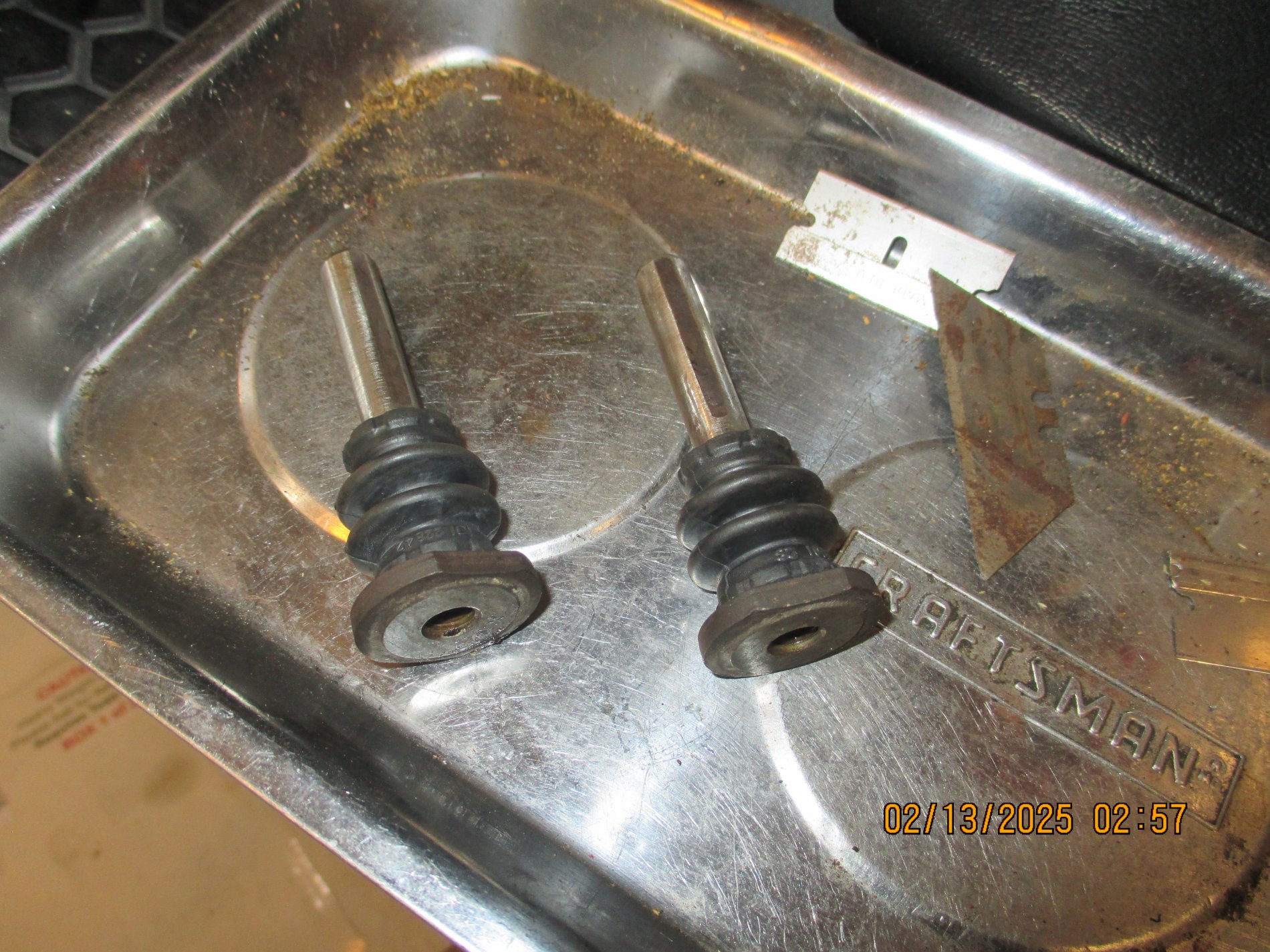

One thing to note about this is that it is only for slide pins that are: For metal-to-metal contact only. It will make the rubber isolators swell and cause a stuck caliper situation.
I accidentally did that on my truck last year. I don't know what possessed me to reach for it (I felt like such a moron!), and by Fall, all of the rubber bushing expanded so much I had a heck of a time yanking them from the brackets. Then I had the fun of flushing the brackets with brake cleaner to get all of the non-silicone lube out of there and replacing the bushings. What made it more interesting is when it mixed with the silicone, it turned the mixture into a chunky mess. Not good and NOT fun! Luckily I caught it in time, and I didn't lose any pads or rotors. Just $20 on bushings and of course my time.
An isolator bushing is the black rubber on the end.
If you have rubber isolator bushings on the slide pins, you absolutely need to use a silicone slide pin lube. I use this Super Lube.
