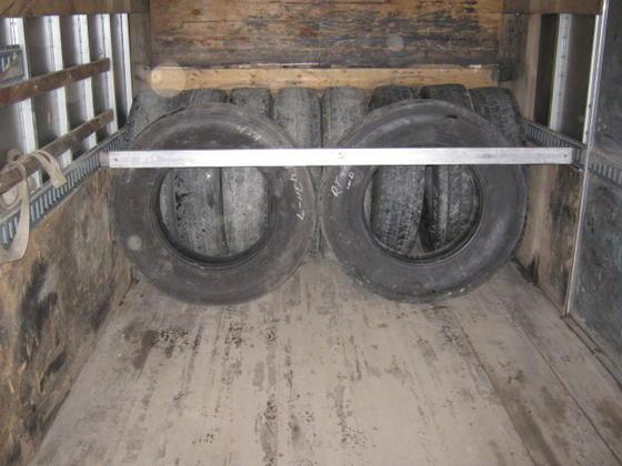

How to get 10 truck tires into a delivery truck without breaking a sweat... ... :D
Fat Old Parts Man's Best Friend!!!

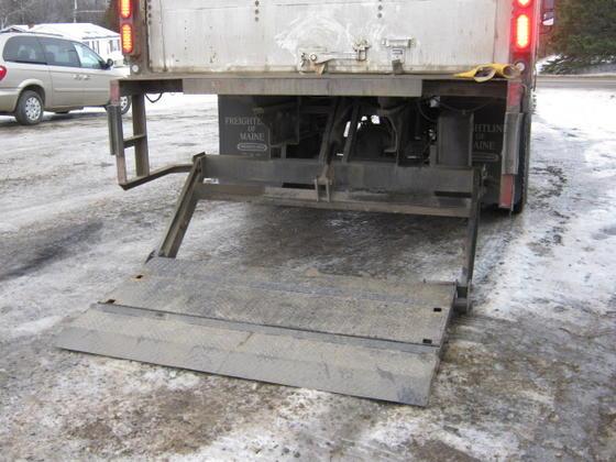

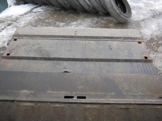

Notice the rectangular holes in the plate.

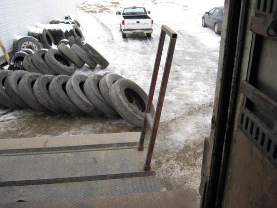

This the tire support that we built, each of the four trucks are set-up the same way.
Notice that the tire support can be placed on either side of the platform, that way you can always control the tires if the truck is leaning one way or the other. Also take note of the two pieces of angle iron welded to the plate to keep the tires from rolling while handling.

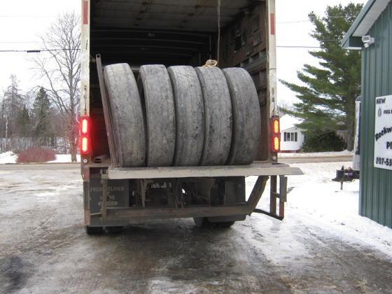

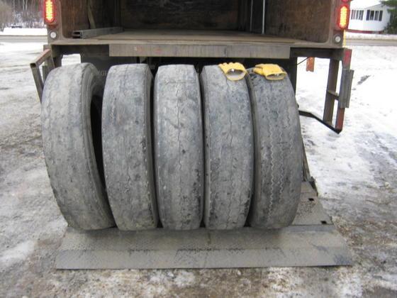

Ready for lift off... .....

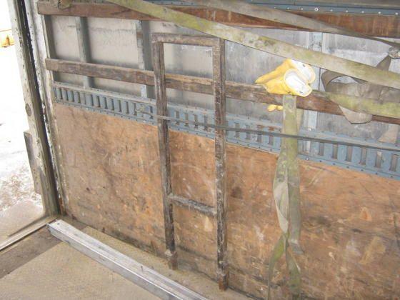

Tires lifted, pure magic..... We stand on the gate while lifting to steady the tires
Ready to go.....
