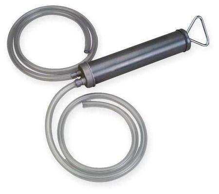

getting ready to get a new steering gear box ( red head )... and by removing the lines you will loose fluid, but do I just suction the rest of the fluid out of the power steering tank or how do you drain the rest of the fluid???? I figured it would be a good time to do it... ... thanks andre
My understanding is you'll have to use something like a turkey baster and suck the fluid out. No drain provision provided.
Go to a parts store and buy a suction pump. Stick hose in fluid reservoir and pull up handle and spit it out in bucket do it a few times then re-fill and start truck and turn wheels and do it again. I did mine several times to get all the fluid it doesn't take much to re-fill each time.
