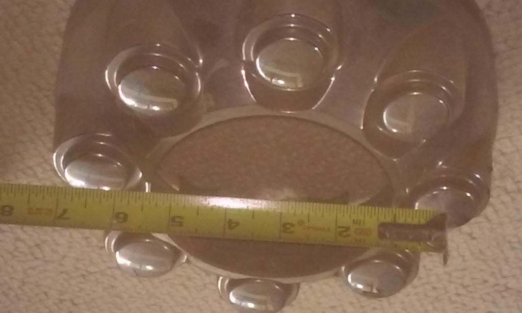

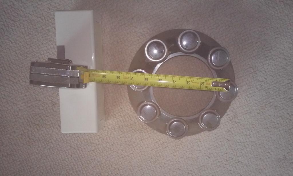

Looks like I used 4 3/8" and it was PERFECT, allowing just enough room for the cap to go over th hub,but NOT infringing on the the circular indentations on the face of the cap that go over the lug nuts. Here are a couple of pics…sorry they are as clear as I could get them. You could go with 4 1/2" but then IMO it would not be quite as clean, though it seems as if others are doing it.
The tape is laid out accurately and burning the one gives you a 4 3/8" hole.
