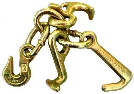

If your car doesn't have that or any traditional tow hooks, they make several different specialty hooks for recovery. J hooks, T hooks, R hooks to name the main ones. They are designed to hook into various holes or grab structural corners under a vehicle. A tow truck driver will have an arsonal of different recovery straps and bridals. There arent many safe spots to hook to a unibody vehicle and a ton of bad ones. The biggest thing to remember is never jerk on a car, even with a recovery strap you can still do some serious damage. if it isn't your car and your not sure, it's best just to help the driver contact a tow truck and let them handle it.

This is what I was referring to by J,T, and R hooks. I have a few of these for tying down vehicles to my trailer. I have used them a few times to pull people out, but given the safe WLL they are designed more for load securing than recovery situations. They are a grade 70, I believe most recovery devices are 100. As long as you are not shock loading them, which is NOT a good idea on a unibody car, they should be just fine. I've also got a few 15" J hooks that work very well.
