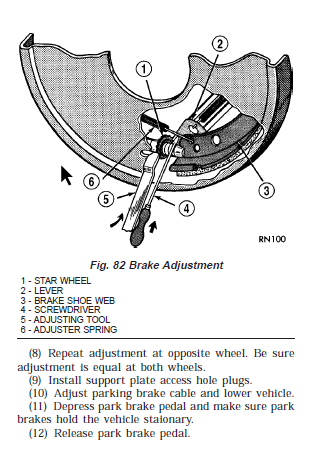

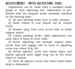

From my 04 manual, I assume all 3rd gens are the same... adjustment on vehicle for shoes... there are other cable adjustments also, If I remember right backing plate is the same part on both sides, so on one side it's almost impossible to get to with the spring pack...:mad: I can send another capture if there you would like. I have the full manual PDF
