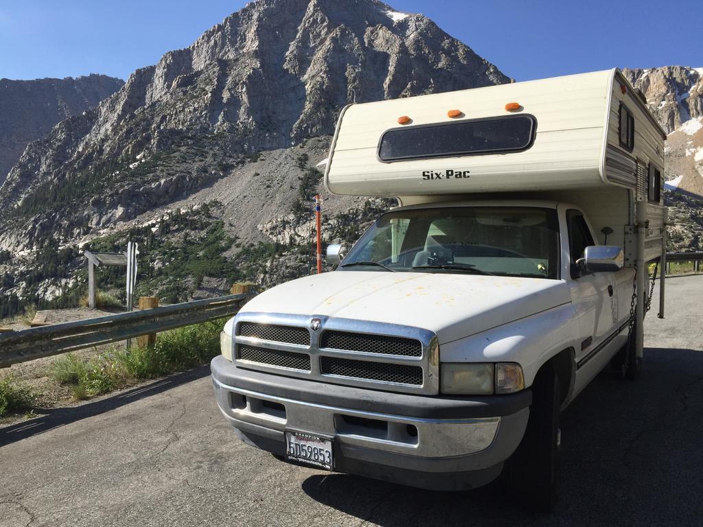

Introducing myself In San Francisco retied pawnbroker with a 1995 2500 cummins 104k miles with a six-Pac 96R truck camper, Got the KDP done, and looking at unobtrusive MPG gains will search the forums
But air intake and exhaust mods will be at the top.
For a stock engine air intake and exhaust won't give you any gains, other than removing the cat converter possibly. A little timing advance and a light foot are the best economy boosters. Welcome to the TDR. Please fill out your signature. Power gain recommendations are different for a manual trans and an auto trans.

I agree with the above... light right foot will help the most

Welcome Wagoneer. Nice truck camper. Not much you can do about mileage with that camper on top. I have a truck camper myself. I love it, but boy does it push air. The first two mods I would do to your truck is a set of 3k or 4k governor springs and replace your throttle positions sensor with a potentiometer. Those two mods will free up your motor and let it run like its supposed to.
