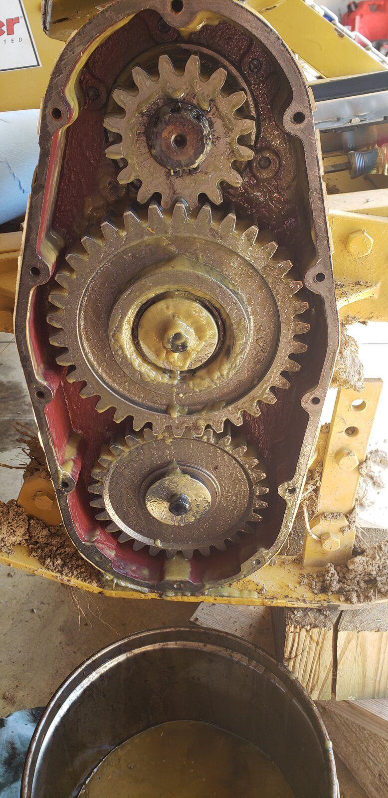

But HOW? it was stored in the equipment shed no rain OR snow fell on it I checked it before last use in the fall for proper lube level used it and put it on blocks.
Went to turn the garden hooked up to the 3 point checked & greased this is what I found :eek:

Weird ??? I had to fill the oil reservoirs both on the side & gearbox from the PTO shaft before use the 1st time. The side gearbox as you can see is contaminated the PTO Gearbox is perfectly clear like it was brand new oil???? That being said I don't know how the unit was treated before my purchase.
Anyway thanks for the thoughts I have some cleanup to do and oil to add have someone use it and change the oil to get any further contamination out before another refill.

No pressure washing, pulling it apart I left the top cover bolt in and put a piece of wood between the cover & body of the gearbox to keep as much crud out as possible while it drained, that could be where the crud came from.
The vent (Not pictured) is at the top directly over the course smaller gear, I also thought that maybe it was pluged but the small covered vent hole was clear.
Im kind of leaning towards NIsaacs idea. Yesterday I went to Rural King and bought a 84" Finish Mower for this seasons lawn mowing chores in the back 7 acres I noticed the Tillers stored outside.
The oil 85/140 gear lube used in BOTH gearboxes was purchased fresh from Tractor Supply, the PTO gearbox oil was perfect the other wasn't, no sign of gasket leaks so no other way except through the vent somehow.
Probably best to get mineral spirits, pan, chip brush and clean everything up and just start fresh. See how it is in the fall.
