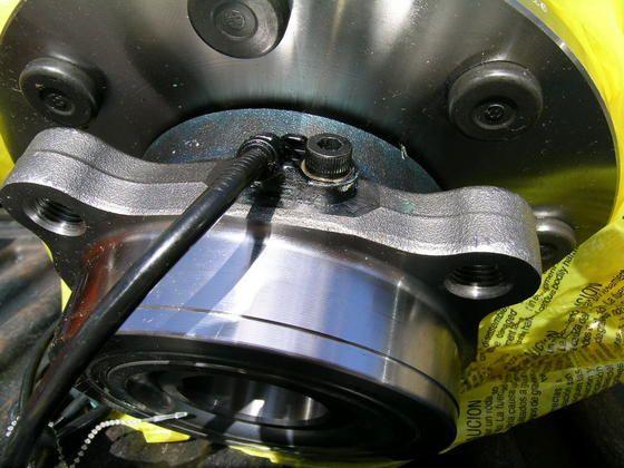

In an experiment I filled a failed hub with water to find out how much it would hold. Only took 20 cc's to fill it so it doesn't take much.

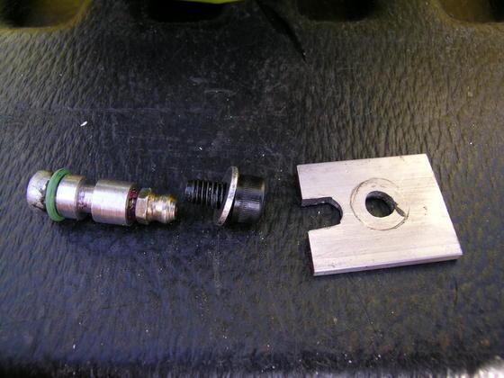

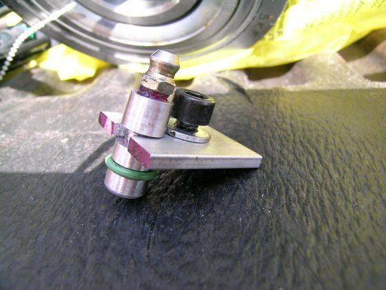

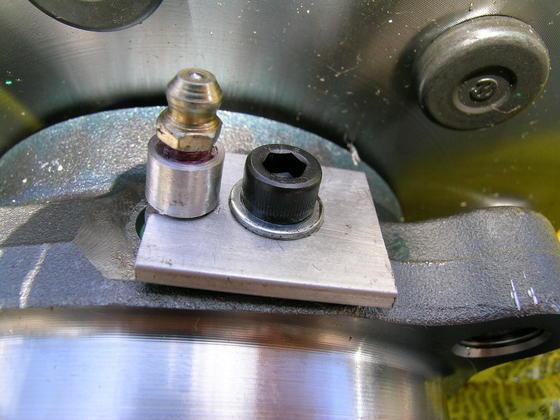

Special tool made to make the process a little easier. You can also use a rubber tipped grease gun tip, but that isn't as much fun.
sag2,did you make that tool?If not where did you buy it?Thanks for posting pictures. I was going to use a needle fitting. Hope to do it this saturday.
Yes I made it. Just a couple of minutes on the lathe.
