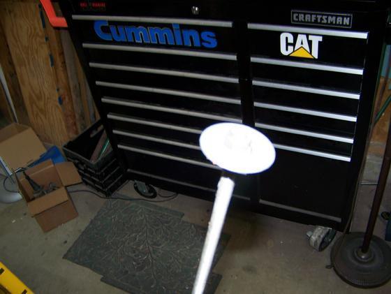

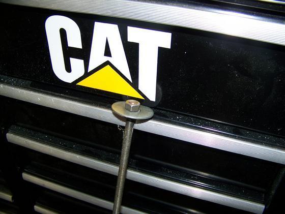

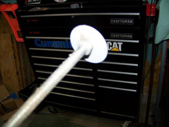

I use this to clean the tube, run it in up to the seal. Drop it and pull the crud out towards you. It will haul 99% of the crud out of the tube with a little patience and repetition.
1 pc 5/16" redi-rod, 2 nuts and 1 fender washer.
