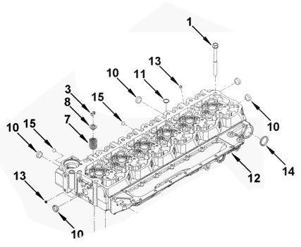

Is it 14 in the drawing attached?
That is the one, shows up as 16 on my diagram, pt# 05016558aa.
