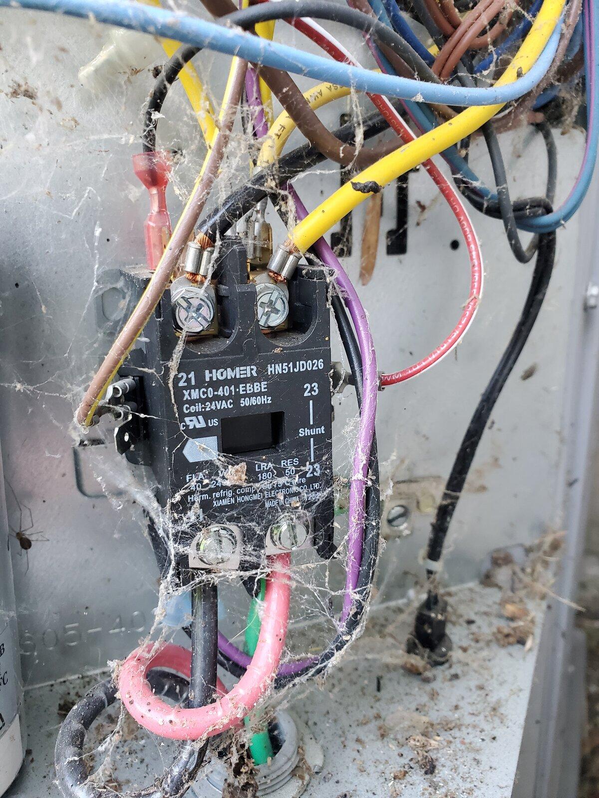

I have a Carrier unit about 7yr old the contactor is shorted.
The board actually has a pretty cool diagnostic code flashing deal, sure enough its right on the money.
So anyone know why the contactor controls one contact and then is a shunt on the other side, so it's basically just jumpered thru internally. My guess is for distribution only cheaper to use this then mount another TB @ 40A.
But is there any technical reason for this or in a bind can I make a single work for the weekend.
I would just leave the one in place with the shunt and possibly add a temp contactor till I can get the correct part.
Its never a price deal, seems most places are closed tomorrow and I have to start work at 5AM tomorrow till who knows when doubt I will make it to a place to get one.
I ordered something close today for Monday, not the exact deal. Will pick a place online to grab the correct part.

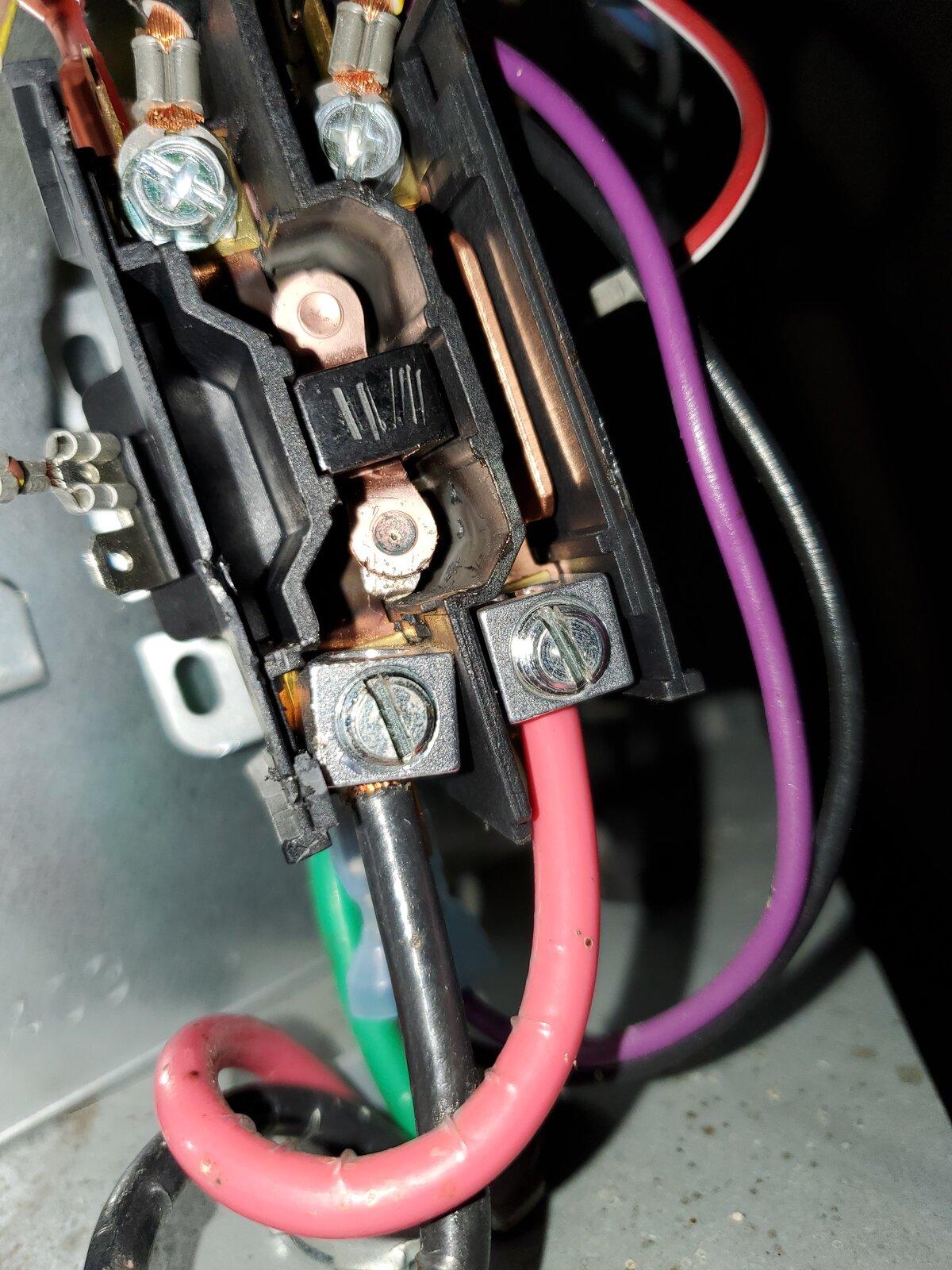

It's fused shut I tried to pop it loose, welded pretty good. We had a utility failure 2 days ago my guess is during my Generator run or the sag event something was undervoltage for a bit or chattered. Doubt its coincidence usually the unit is off for generator runs I forgot and left it on and it tried to run and my wife said the lights started flickering pretty bad.
Guess I should clean this out more often, out of sight out of mind.

This is different then the Shunt Trip for a breaker, but thanks for looking that up, this is like a 2pole contactor but one pole has a bar across the contact.
So the left contact is number 11 is L1. 12 is L1 out, then the second pole is number 23 is L2, and the top side is also 23 L2 but does not switch.
My contactor is essentially shorted closed on 11 and 12, it shifted into Emergency Mode and shuts something down,

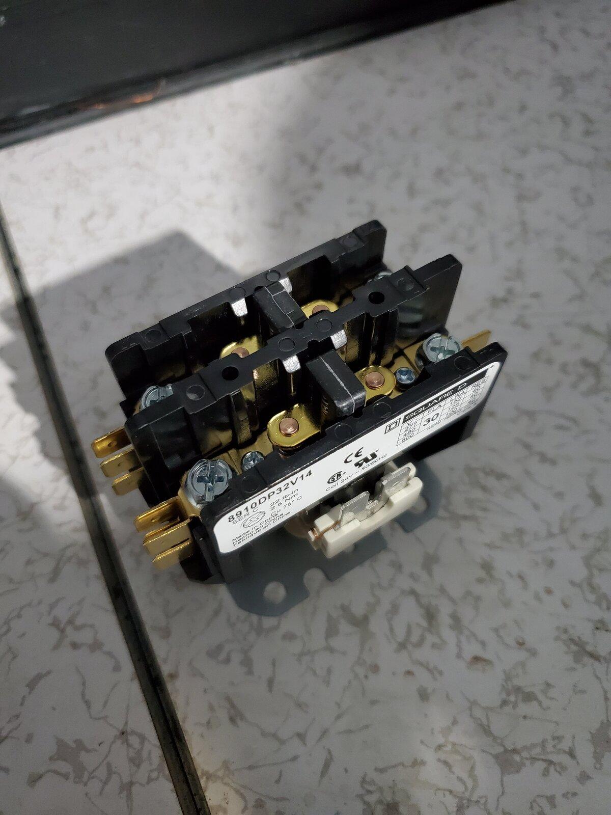

So guys at work had one, yeah they tell me it's just a cost savings to have one pole be a contact other is feed thru.
They had a 2 pole, said no issue throwing this in.
So later at home will swap it out.
I also ordered a 2 pole so will have a spare.
