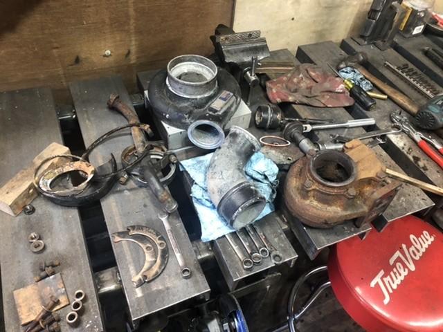

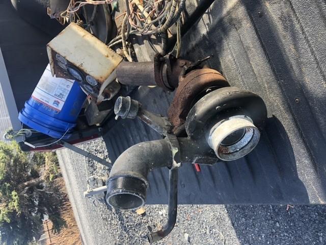

Found this on the side of the road!
No, not really... it came off a truck that caught fire. But I did get it for free.
Broke it apart; everything separated fairly easy. No heat deformation; the fire originated in the cab, and was extinguished shortly thereafter.
Compressor wheel spins freely, however it’s missing part of one fin, and seems pitted. Also; there’s a fair bit of end play (I’d estimate 1/16” of endplay).
The wastegate actuator was corroded on the exterior; however it holds pressure and moves freely.
Replacing the internals was already part of the plan. That being said, what would be the recommended course of action? Source a genuine Holset rebuild kit / compressor wheel? Find an entirely new cartridge? The truck currently has an H1C (original). I’m under the interpretation that the cartridges are identical aside from the compressor wheel? Perhaps a better move would be to rebuild the original housing and swap a compressor wheel?
All that I’ve been able to find thus far are Chinese knockoff replacement cartridges... I’ll contact Cummins Northwest and see what is available for genuine Holset.
