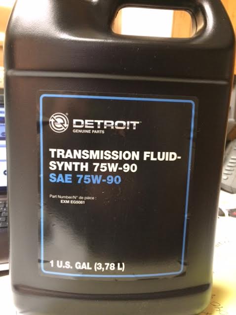

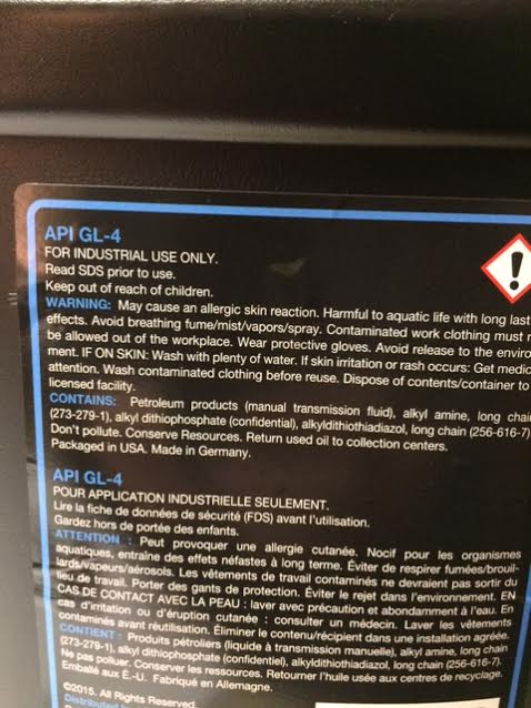

Sooooo....I don't own a standard and have no horse in the race....
BUT....what do you suppose this fluid is?? It is an Exxon-Mobil product, only available from Daimler Trucks NA. Used in this transmission...
https://www.demanddetroit.com/transmissions/
Now I see "Synthetic Transmission Fluid - Synth 75W-90" and on the back "API GL-4"....Also made in GERMANY.....My local distributors can't even get any info on it..
What do you think it might be under all of that Detroit Diesel packaging????
