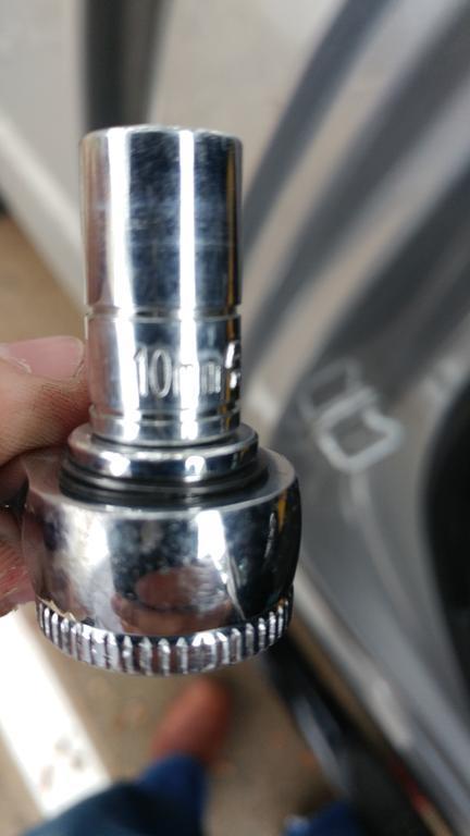

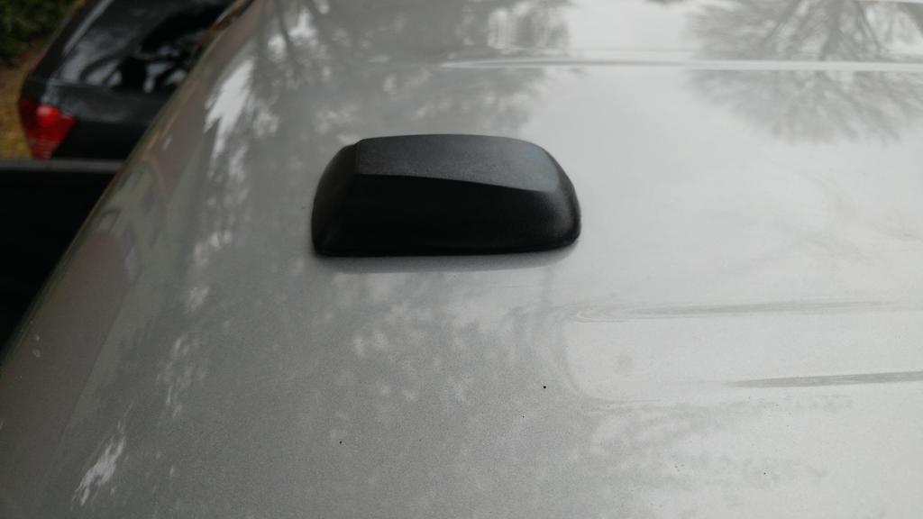

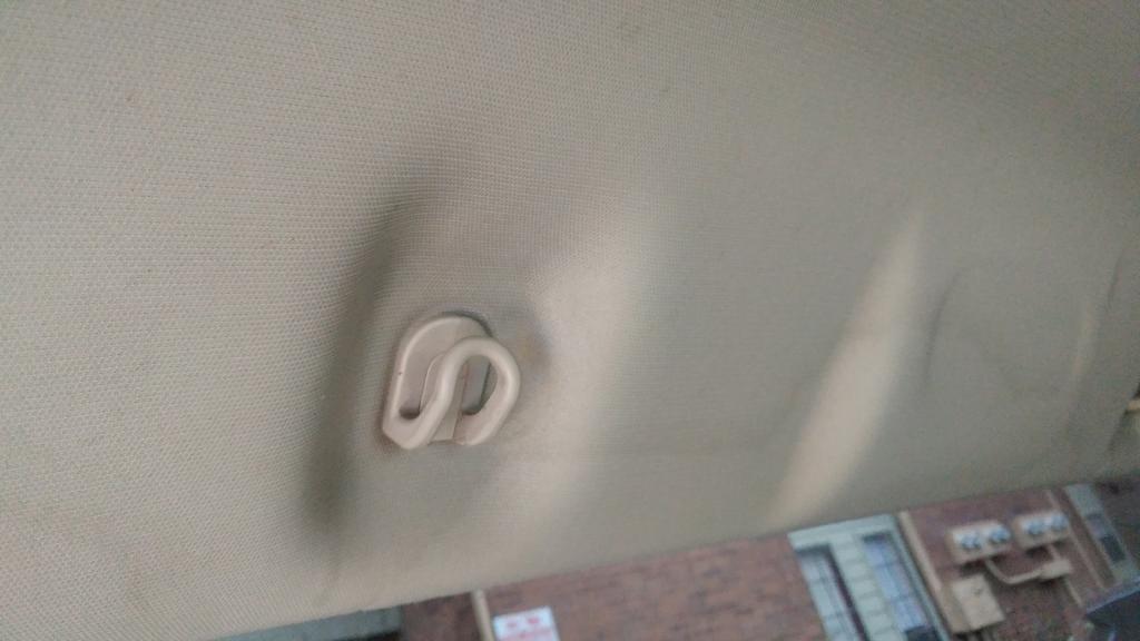

Pressed down on sat antenna by luck and water squirted out at me, so I removed the passenger rear seat belt pillar Phillips head screwdriver ( suggest magnetic screw driver), t20 screw holding in the coat hook on same side, pulled head liner down and removed the 10mm screw holding antenna in place. Unclip yellow connector coming from antenna, just and easy push and pull
Now I broke the plastic clips that add a little extra security to holding antenna in place to remove it but the silicone I use will be better at holding it. I drained the water out of the sat,. Covered bottom in silicone as well as the outline of where it mounts to cab and reinstalled. Shouldn't leak anymore and if it does I have bigger problems.

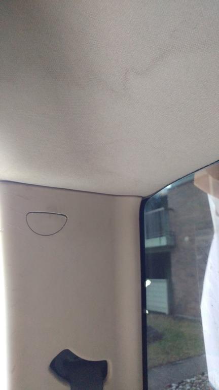

Maybe next I'll paint the headliner black to cover the water spots in the rear.
I got the water spots off my headliner and seats with the aerosol can of upholstery shampoo with the scrub brush on the end. I believe it was made by Turtle Wax.

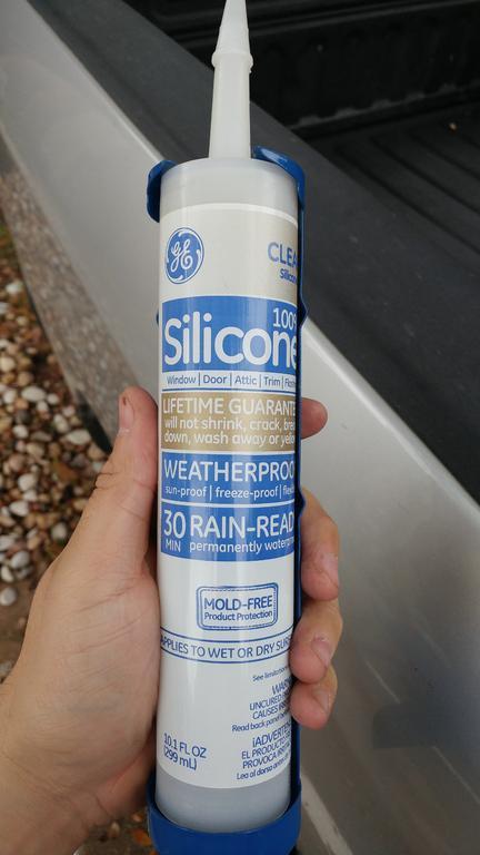

We use about 100-200 tubes of silicone a year. The GE stuff is bad about 20% of the time. 1 in 5. They look cloudy and gritty. They do not cure. If using that brand we do a test spot to see if it skins. Then leave a dab on a paper towel over night to check that it cures.
If you want good silicone easily available get the Ace Hardware brand. It is not low VOC and stinks like the good old stuff. But, it is extremely clear and cures much better. I have never had a bad tube using that brand. FYI.

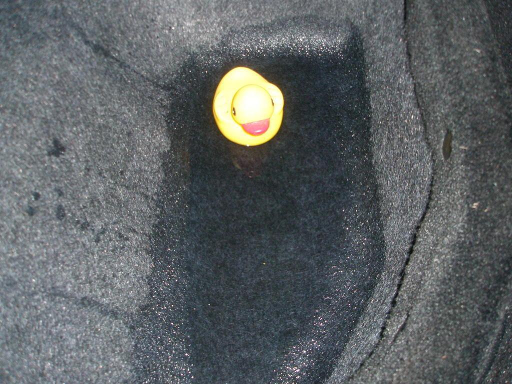

Did it look anything like this? This leak has been around on RAM trucks since at least 1995! Many threads on this site. Chrysler/FCA/RAM engineers/designers should be ashamed that they haven't fixed this in over 20 years!
This happened to my truck when it was only a month old. Two inches of water in the storage area. Dealer siliconed the third brake light and tried to give the truck back to me with water still there. I made them dry it out!
