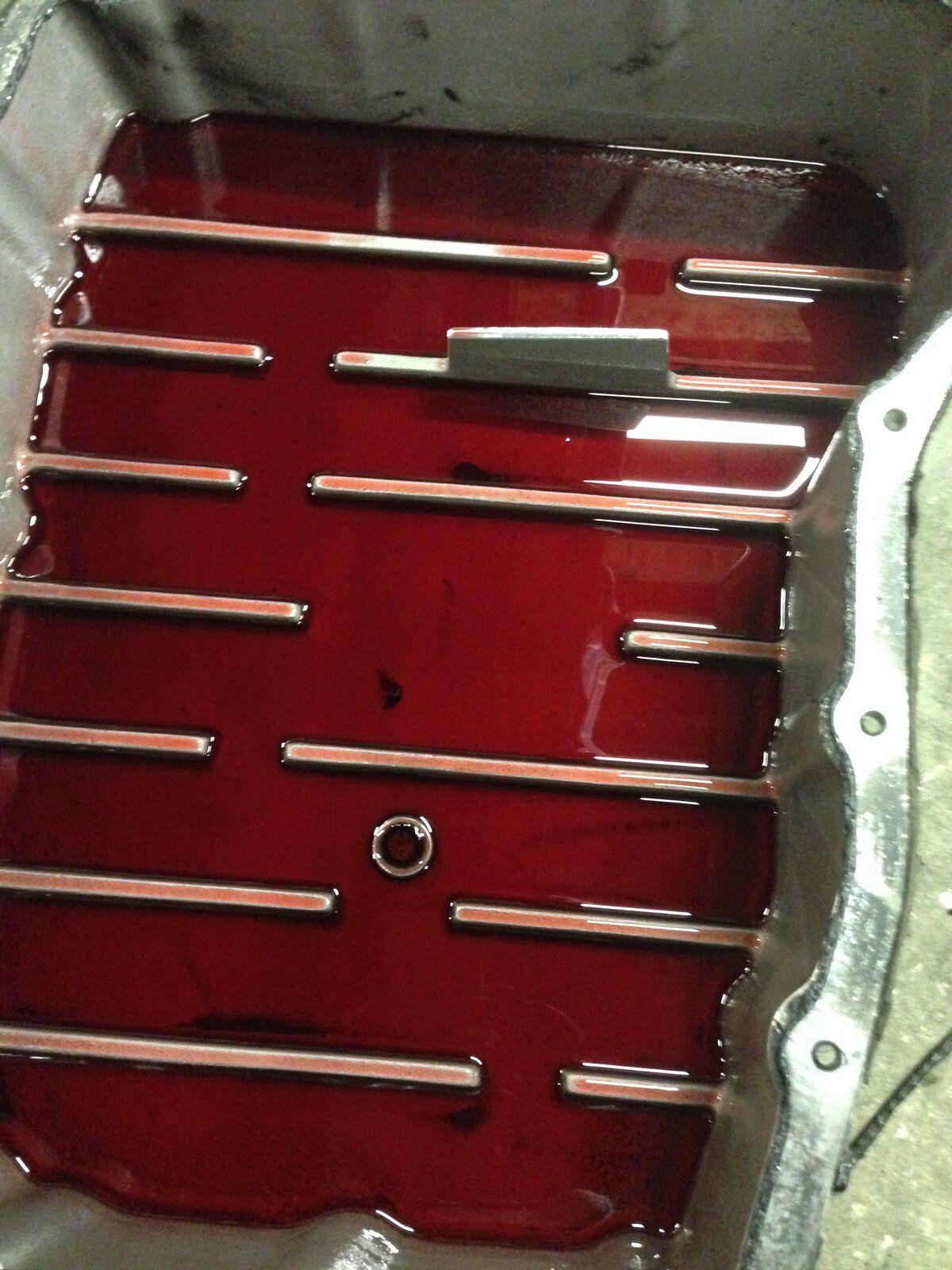

The 68 needs NOTHING!!! Here is my pan changed OE fluid completely to AMZ/OIL at around 5k. This pic is at 65k towing WAY over 1/2 of it'e miles 28-29k combined.
