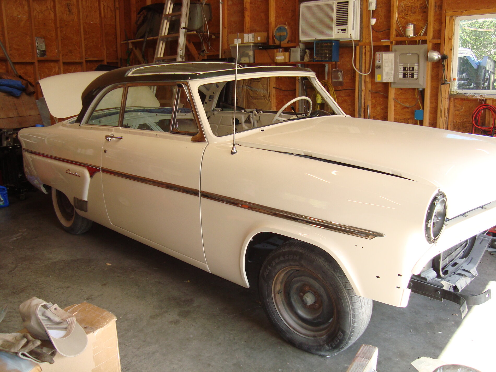

I then re-evalulated changing them out. The seep is barely noticeable, the clutch starts to engage with the pedal about 2 inches from the floor and there isn't any real problem. I decided to take the truck off the jack and get back to a high priority of my time, a newly repainted '54 Ford restoration.

Nice project to go back to....
