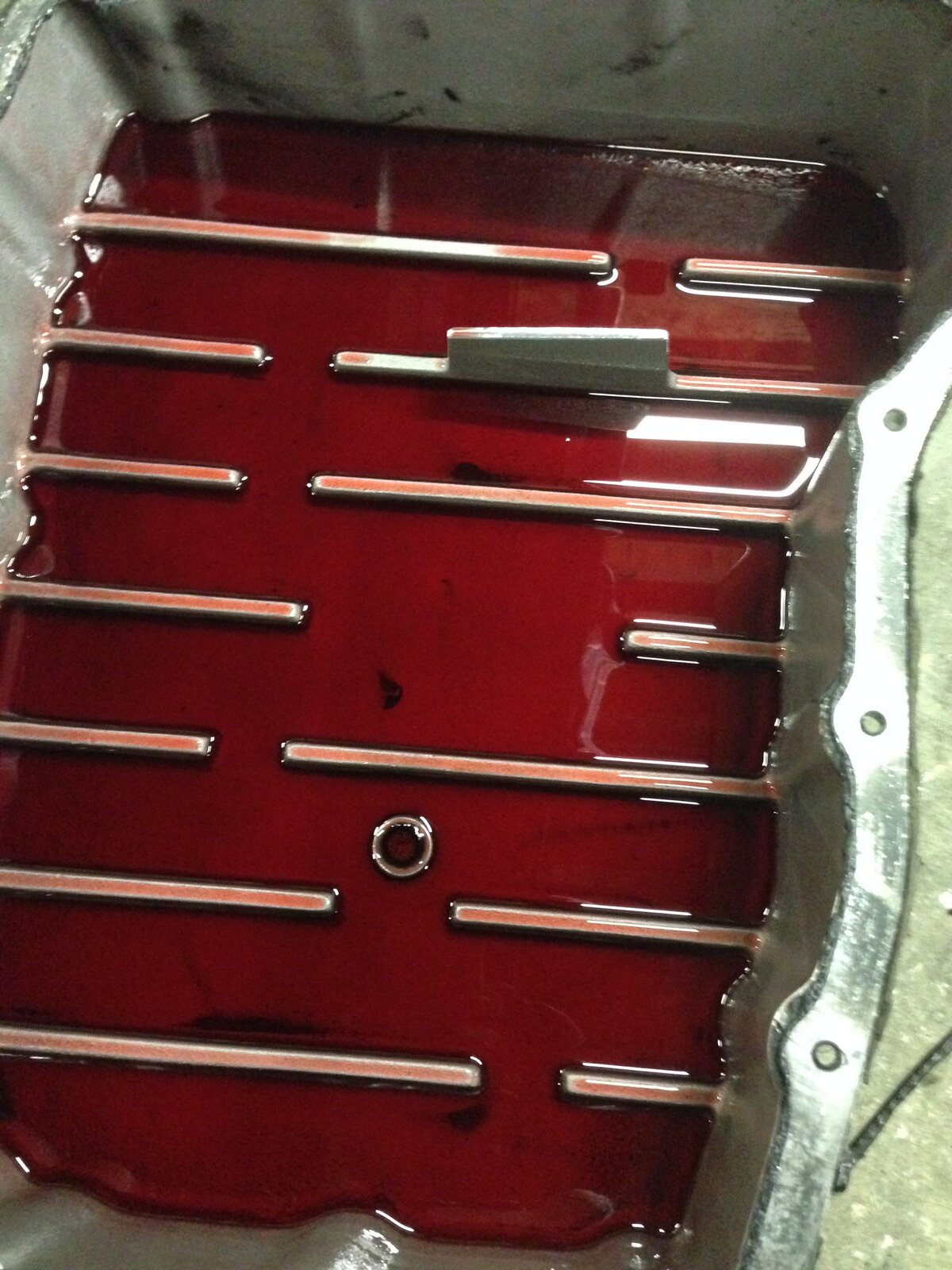

Removed my double deep pan when trading 11
on 15 at 65k well over 1/2 towing 29k. Over 50k on the AMZ/OIL.
