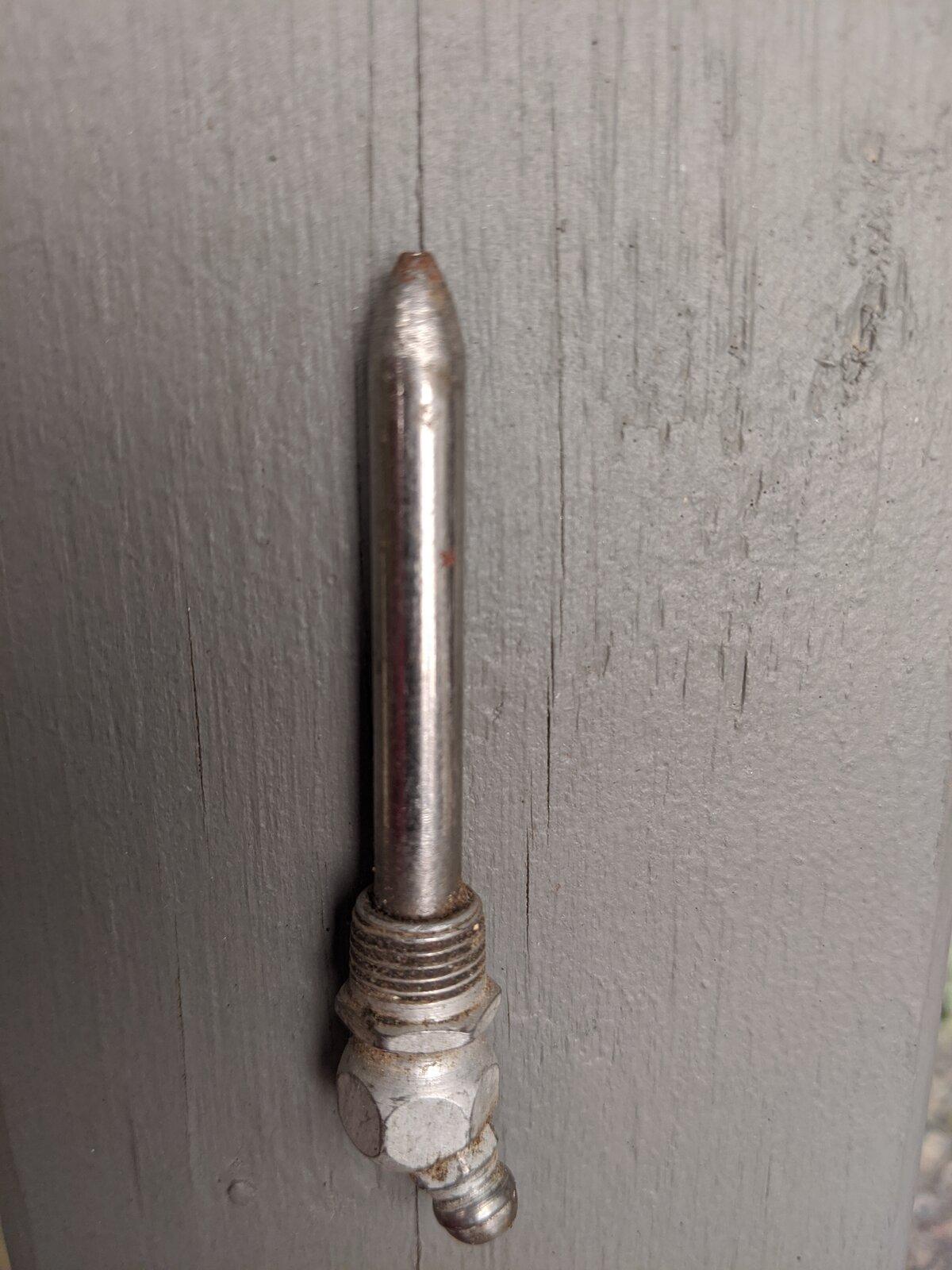

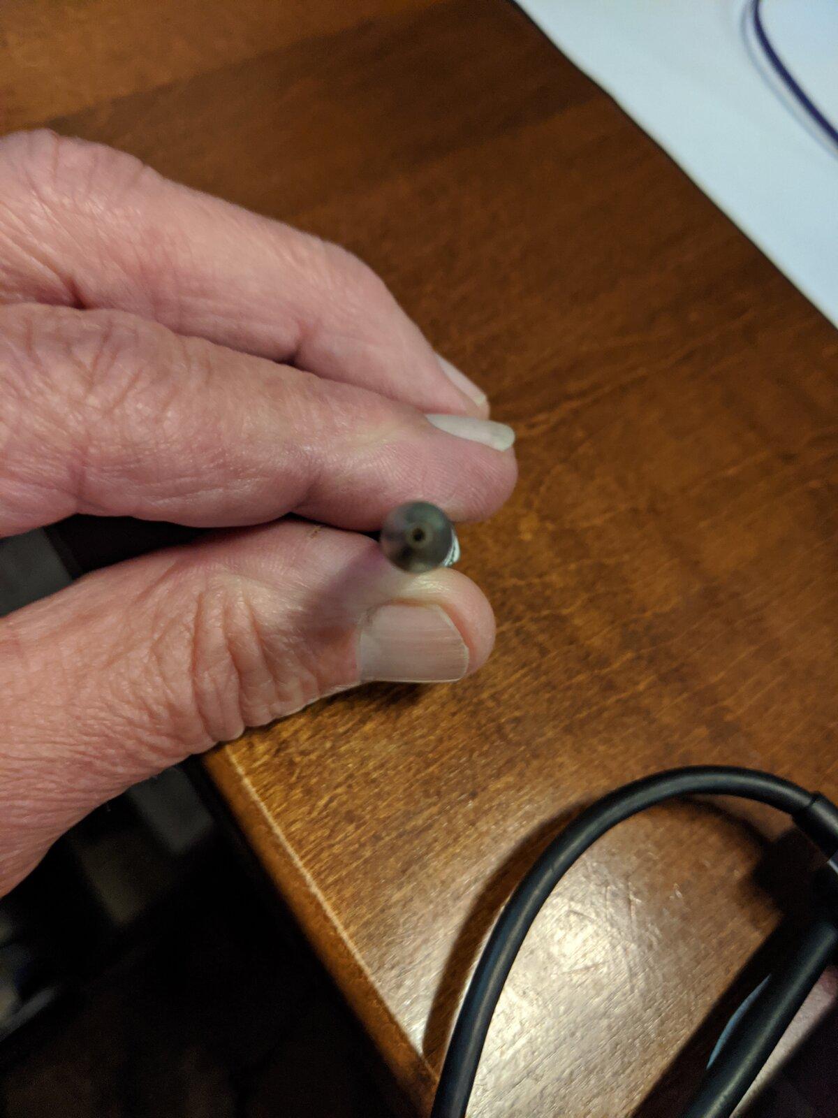

Autowriter, thanks for posting this, it reminded me that I need to grease mine before leaving for Arizona. I made my own grease gun adapter quite a few years back. It works well, as the tip I ground fits nicely in the grease cup on the joint. Drilling the small hole the length of if was a challenge. I think I used a the non threaded part of a 1/4 bolt to make it.
