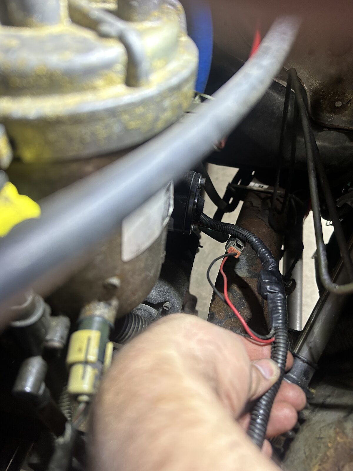

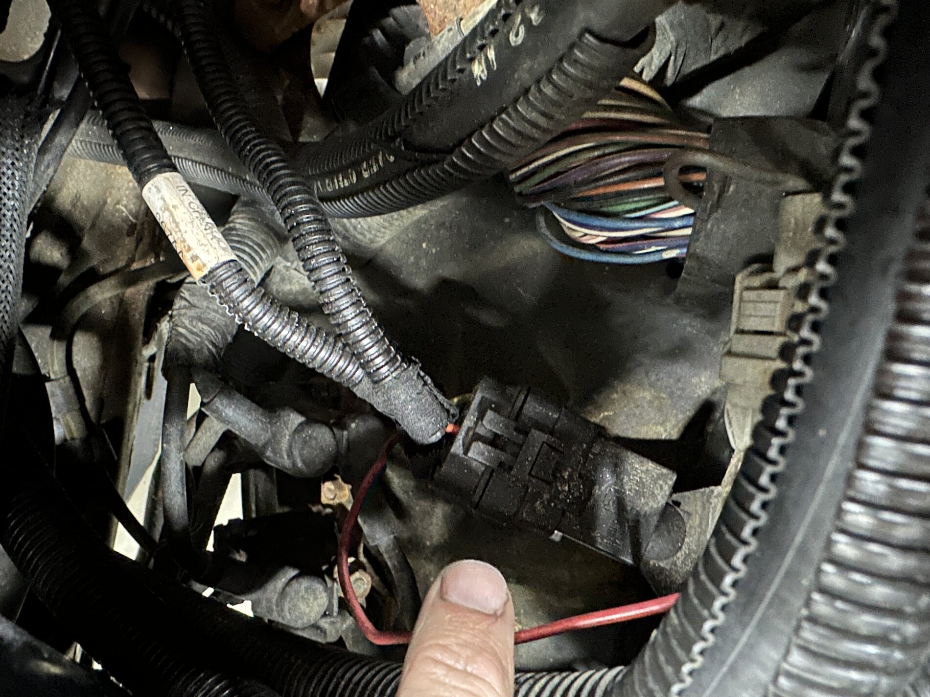

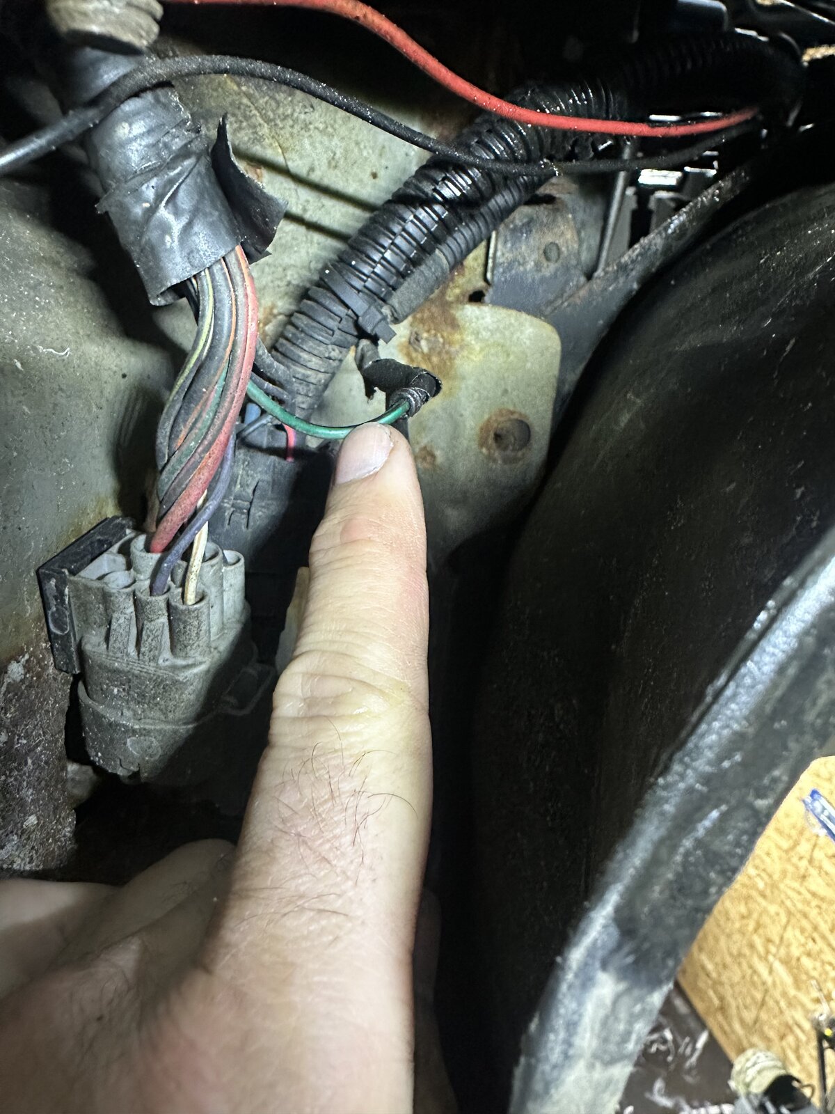

Hi, So my son recently got a 1998.5 24 V, While changing the battery terminals tonight I noticed a relay near the battery, Two Wires run towards lift pump and I think get spliced in with one connector with 2 wires plugging into the DDRP on the block and the other connector plugging in near the block, One wire which is orange runs down and connects to a green wire under truck kinda near the fender where I think it runs towards tank. the last wire from relay goes to battery power.
Is it possible I have an in tank lift pump and a Block mounted one?
How can I verify?
Is it bad running both?
Truck runs great , I plan to hook up a fuel pressure gauge in the near future.
Thanks

So I bumped the key and the tank buzzes as does the Block mount so I am running 2 pumps, It has a new DDRP Fass block mount. But in order to get the pump out of the tank I'll need a non intake pump sump set up which I am seeing for over $400, I might as well upgrade everything for that price. It's working as is so I am going to get a pressure gauge set up and start there.

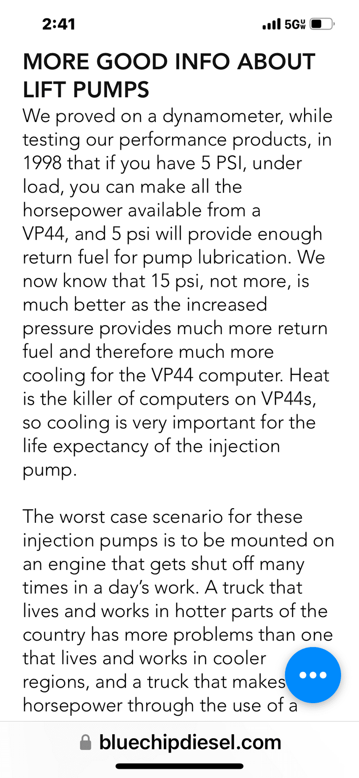

https://www.bluechipdiesel.com/diagnosing-a-lift-pump-issue
