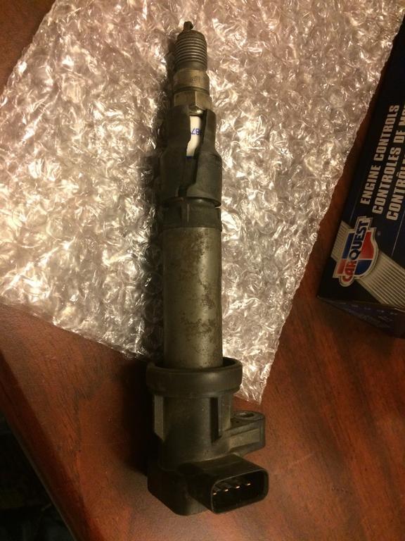

Put my code reader on it and after a couple minutes of idling a code for a #6 misfire came up...Hah, bad coil pack.
Pulled it and it had a split boot. Original part so I went over to Advance and grabbed a new one. Put it in, still skipping but misfire code gone. Other codes though.

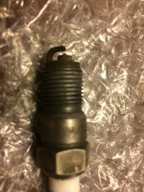

Decided to swap #6 and #8 to see if anything changed......pulled #6 coil and the spark plug came right out with it, the new boot had suction enough to bring the plug . Well there, I found the problem..
The coil pack held the plug somewhat in place, on second inspection of the old coil I could see where the bouncing plug had been shoving the internals of the coil pack...plug couldn’t get out..
