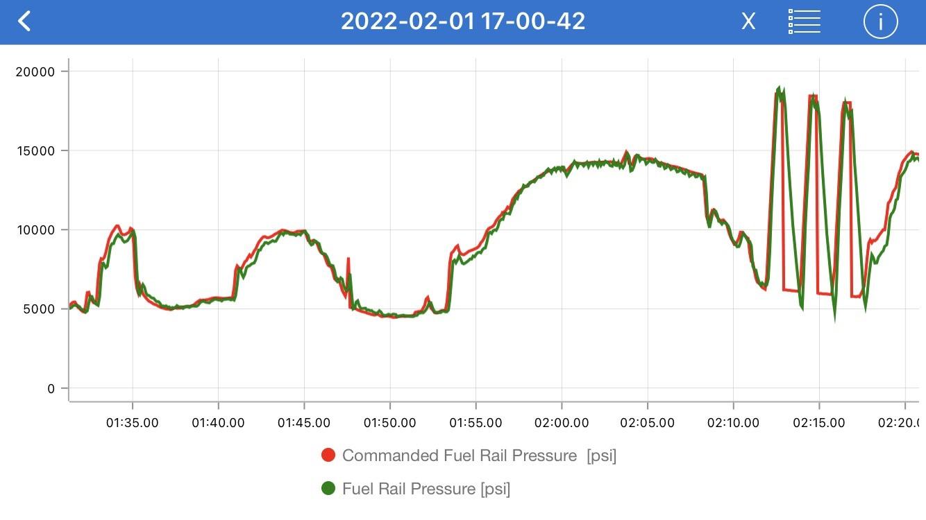

Has anyone been able to resolve MIL code P0191 (Fuel Rail Pressure Sensor Circuit Performance). I've replaced the fuel rail pressure sensor, fuel control actuator (FCA) on CP3 pump and fuel filter twice in the last year. I've cleared the code as I haven't really noticed performance issue. Lately I have notice more idle fluctuation and code keeps coming back quickly. My truck is 2012 Ram 2500 completely stock with 145,000 miles. Attached is fuel pressure data logged. It looks to me my CP3 pump is able to make commanded pressure. I have a lot more data but CP3 can make from 5K to about 25K psi pressure. I would be interested in seeing others fuel pressure data. I would really like to get this issue fixed. Don't want to keep changing expensive parts. I've read if I had a bad injector I would see white smoke, but with DPF lifter we won't see white smoke on stock trucks. I get about 11.5/12MPG when pulling my 32ft trailer and about 14MPG unloaded. I'm thinking this about normal. If it's a bad injector it doesn't seem to be too bad. How long can you drive on a bad injector without causing other problems? Thanks for any suggestions.
