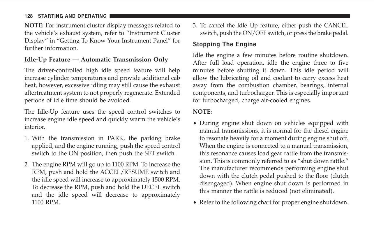

I need to idle my truck in 80 degree weather with the air conditioning running for 5 hours, will this harm my 2018 3500 truck
We have a great feature built into our trucks to help with that. With truck in park and E brake engaged, turn on the cruise control, press the set button. This with turn on the idle up feature, RPM's will go to 1000RPM's. You can increases to 1500 RPM's by tapping the accell button. This helps with wet stacking and allows engine to turn at better rpm as if driving. Hope that this helps with needing to run the truck while stationary.
Sometimes, better safe than sorry! Yes, it will work either way, but stated it as manual states.
My manual states nothing about the the exhaust brake to use the idle up feature.
Also, it goes to 1,100 rpms at activation.
Are we talking EMERGENCY brake or EXHAUST brake? I’ve not owned anything newer than a 2nd Gen, myself, but I recall the Ford ambulances we worked on would go into high idle if you set the parking brake and some of our buses do the same.

Ah yes, probably …. But generally in the diesel world e-brake is exhaust brake. Emergency brake or parking break is that. Manual does call out parking brake use.

So I went and looked in the manual. Nowhere does it talk about using it as an emergency brake, just that it should be used for parking all the time. The manual is very clear that park should not be used as a substitute for the parking brake.
