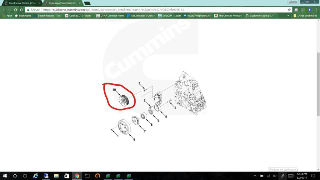

Just to be clear, Item #10....people have different terms for parts and want to make sure that you get the right part..
Yep that's the one. It appears it comes with the standoff and bolt, which is good since the standoff was slightly damaged when the bearing let go. Weird thing is I heard no abnormal noise yesterday. Started it up this morning and heard a racket. Backed up 10 feet, stopped, popped the hood and saw a spark fly off the idler pulley. Shut it down to decide what to do. Should have got a flashlight and looked into it more closely. Instead I started it back up to pull back into its parking space to deal with it after work and boom the bearing let loose and the belt snapped. From the the discoloration to the races it is clear the bearing had overheated and I don't think it ran long enough this morning for that kind of heat to build up. Must have been going bad for a while and couldn't be heard over the engine noise.
