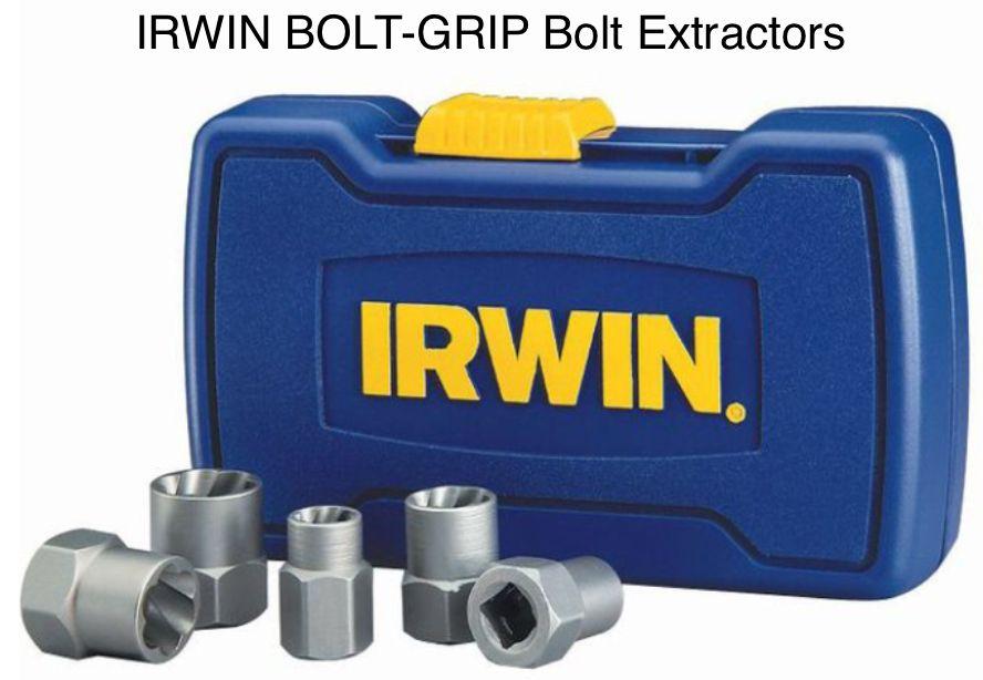

Get you some. Best thing since Vise-Grips. This set is $20 at Lowe’s.

I went to Lowe's and picked up those Irwin bolt extractors. I think I got it to turn, but even if it does, I can only back the bolt out so far before the extractor is up against the frame. I guess I'll try that and see if I can see enough threaded portion to get a hacksaw blade on and cut it off.

If you got it to turn even a little bit, you're probably back in vise grip territory.
Nope. Tried the vise grips again and couldn't get it to turn. I haven't tried reheating it yet, though.
