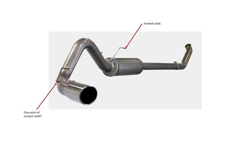

I'm looking at AFE's website and they show a picture of their 409ss 4" system (49-42004). I would be concerned about the longevity of the weld on the hanger to the tailpipe, it looks like just a small point of contact weld. I do like the hangers in that they have a formed end like the OE ones.
