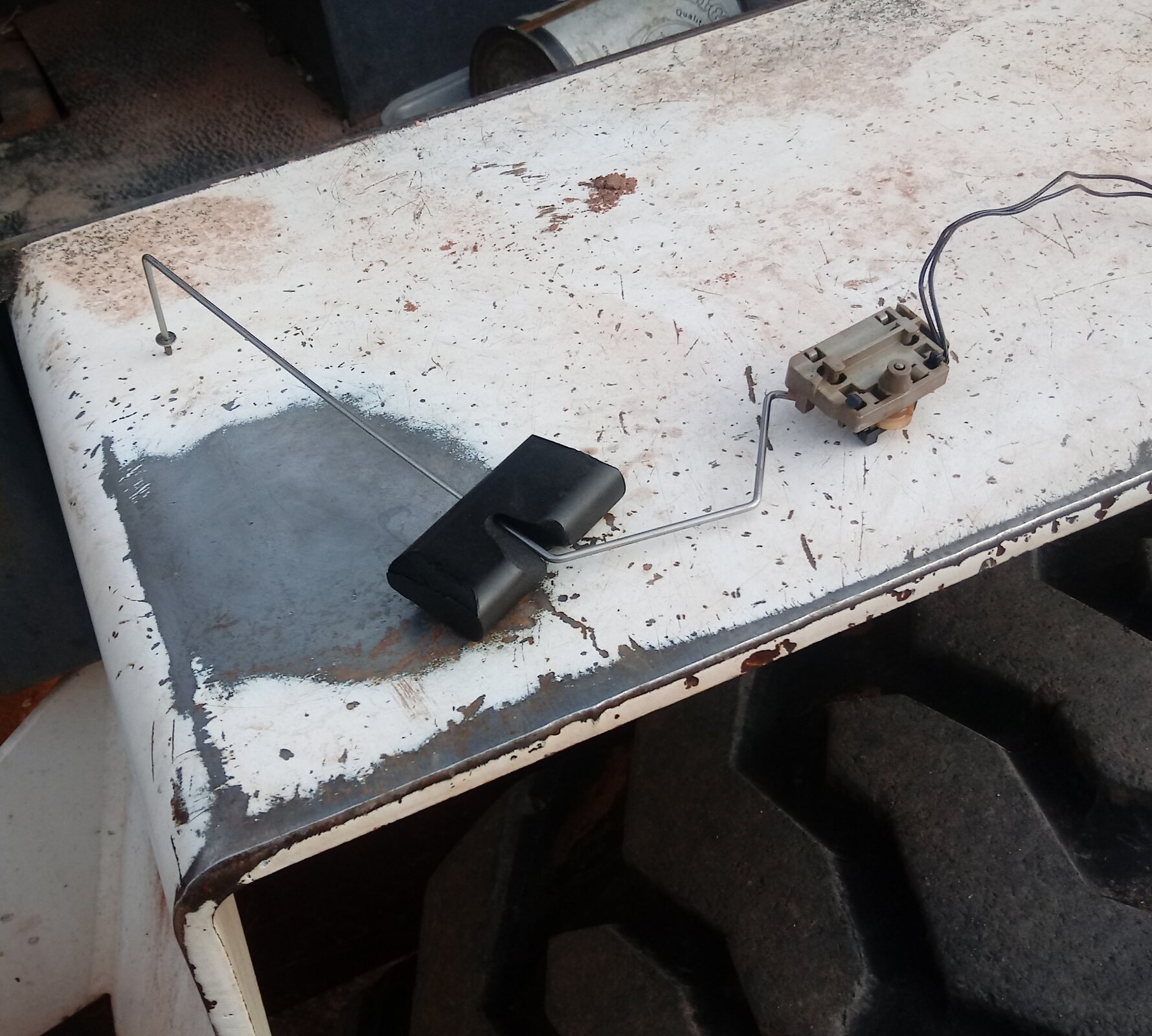

I was wondering if anyone may have any ideas what may cause the fuel gauge to read incorrectly. The tank was empty when it read just above 1/2 on the gauge. When I fill it up, the gauge reads above F until I am at about half a tank, then it starts reading from F to 1/2. I usually fill up once a week regardless and have gotten pretty good at estimating fuel consumption based on miles driven but I’d like to fix the gauge. Any tips on where to start. From preliminary research it seems it’s either an issue with the fuel sending unit, the float, or the gauge cluster. Wondering if anyone had any tips?

That era of dodge ctd’s were notorious for sending unit failures. If you search on here you should be able to find a lot of threads about it as they used to come up somewhat frequently. There were some diy fixes such as sanding the contacts, using a screw to adjust or along those lines. You used to be able to buy just the sending unit assembly. In fact I just checked genos garage and they have just the sending unit as well as the whole fuel canister assembly if you go that route.
Not that the cluster can’t be the culprit but it was usually the least common issue . Same with the float they did sometimes disintegrate and were the cause. You can check the resistance readings on the sending unit though I don’t recall the range off the top of my head I do remember that they were different than many am thinking 20/220 +or- 5 or 6 ohms but that is vague memory
I had to change the sender on my '01. The float wore out on the arm, slid down the arm and just floated up and down the arm.

The Gen 2 sending units are notorious for being unreliable and short-lived. (The sender float on my 1996 wasn't as bad as the one on Nick's 2001, though.) I replaced both sending units (OEM tank and Transfer Flow Aft Axle tank) about 5 years ago in a week-long ordeal. The replacement (from Geno's) was dead accurate for about two years. Then it began to show 7/8 full when full. Even that is a vast improvement from it not working at all and relying on a guesstimate of fuel mileage.
When the original OEM tank sender failed, that's where the failure began. It eventually got to the point where the best it reported when full was 1/8 tank. When the low fuel warning light was illuminated at a full tank was when I replaced the sender.
