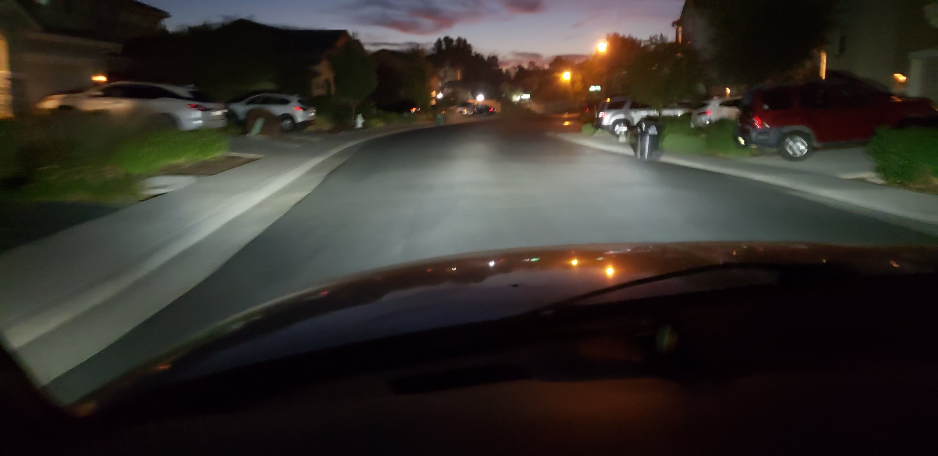

On the advice of a mechanic ive used a few times; I got an LED kit for the rear lights. It plugs into the the top socket in place of the bulb and reuses the lower light. That and cleaning contacts fixed the problem. The LED is now responsible for the turn signals. Accoring to said mechanic, theres virtually no difference between all the kits he's installed. The $100 kit is just as good as the $500 one. Time will tell if its reliable, but its a vast improvement in visibility. I also got LED bulbs for the front, so hopefully i wont need to leave the hi beams on anymore.
Installing LED lamps in a housing that has reflectors designed for halogen lamps is not a good idea. The light will be scattered and will adversely affect oncoming drivers' visibility.
A better solution would be to do the Sport Headlight conversion and relay the headlights in an OEM manner. Stay with good quality halogen bulbs. Much better lighting - both low and high beams.

What bulbs are you using? The only bulbs ive found for the factory headlights are sylvania and they suuuuuck. Ive never had one last more than 2 years, and the light output is as stated, bad enough to run with the brights on.
It's not about the bulbs
I am assuming that you still have the OEM 2 bulb headlight system. If so, that is a very poor lighting system from the factory. The reflectors are poorly designed and very little of the side of the road is illuminated on low beam. The 9004 bulb low beam is only 45 watts - de-rated for longevity as compared to a standard 55 watt low beam bulb. Then, to top it off, there are long runs of undersized wiring through the headlight switch and low / high beam selector switch and eventually to ground. There are no relays to improve voltage to the bulbs. And, of course, as the lens degrades over time, matters only get worse.
The result of this OEM wiring is that there is less than 11 volts available measured at the bulb with low beams activated and engine running - and this is when the truck is new!. Voltage should be a minimum of 12.8 volts (American bulbs) and 13.2 volts (European bulbs) measured at the bulb to get 100% of the rated bulb's output capacity (typically rated in lumens). At 11 volts, illumination output is reduced to around 50% of bulb's rated output capacity. You can buy the best bulb in the world and it is not going to help with an OEM 2 bulb headlight system.
A 4 bulb OEM headlight system (called Sport Headlights) is a much superior system. It is relayed and uses two 55 watt filaments (outside lights 9007 bulb) for low beam and four 65 watt filaments (outside 9007, inside 9004) for high beam. The reflectors are of good quality and light up the roadway and the sides of the roadway very well on low beam or high beam.

I went with the $50 amazon special. They are much brighter and im not lighting up anyone's back window. Longevity will determine if its a good deal or not, but no more high beams on the freeway.
