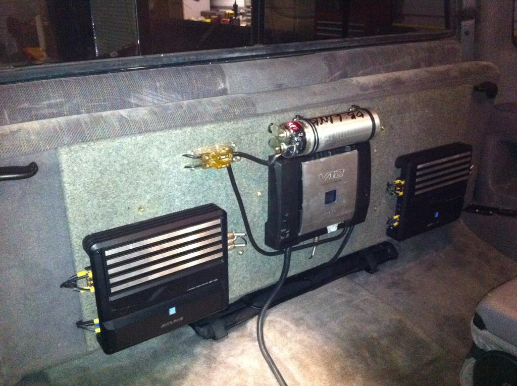

Several years ago, I replaced the head unit with an Alpine, and it ran straight through the factory speakers. Several weeks ago, I replaced the speakers with 3 way Alpines in the front and 2 way Alpines in the rear. I just hooked up the front speakers through the old amps. I just remounted the amps to the door.

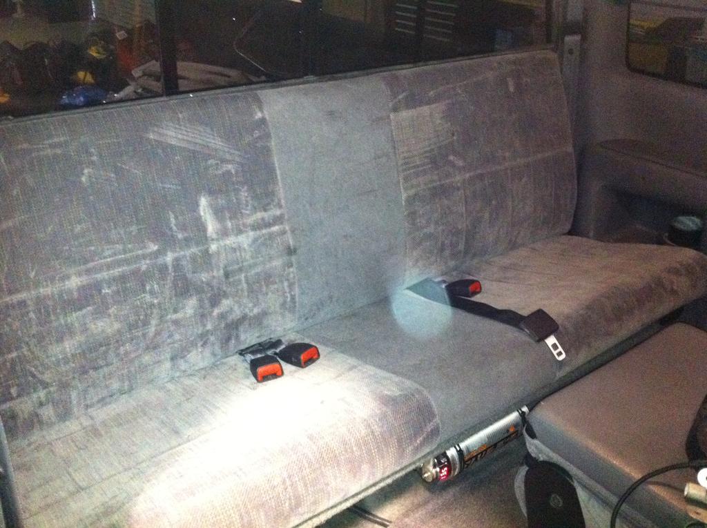

Hey Vaughn, Just go wild...you know you want to. Here's what i did when i finally got an extended cab truck... ;) totally invisible... 4 6.5" components separates w/1" tweets. and 1 JL12" stealth box in the middle seat location. 107db A, clear as a bell. When the ricers pull up next to me cranking up their distorted crap...i just roll the windows down and grab the nob and let some Big and Rich roll. Gets a lot of funny looks when the stereo covers up the rattle of the cummins!
Ya' know, four bolts, a lift up on the seat, and the whole rear seat comes forward... then some FatMat against the back of the cab, which isn't insulated anyway, and you can mount the components a little more solid to the back of the cab.... Just my preference.... Other, perhaps even larger, hardware has a little more room to breath... (Just a note: You might want to vacuum that back seat a little before hand... the dust tends to fly out when the volume goes up... :D) Nothing against what you did there, it looks neatly done!! I like to keep that area clear, though. Makes room for the bang sticks....
