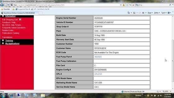

Ray,
Typing with one hand so forgive any errors...
Can not pull up ESN, get me all 17 digits of VIN and I can get at it through Cummins.
Tran is Eaton/Fuller FS6306A.
Rear Axle is a Meritor 20,000lb unit. Model RR20145. Ratio is 4. 33.
Looking for a ratio / speed chart, will post again once I find it.
Mike.

I think the "A" box is direct drive, if so, 4. 33 will be on the slow side even with big tires. That transmission is also on the light duty side, so the Cummins will also be low powered. Maybe around 210/605-250/660. Just guessing:D
Nick

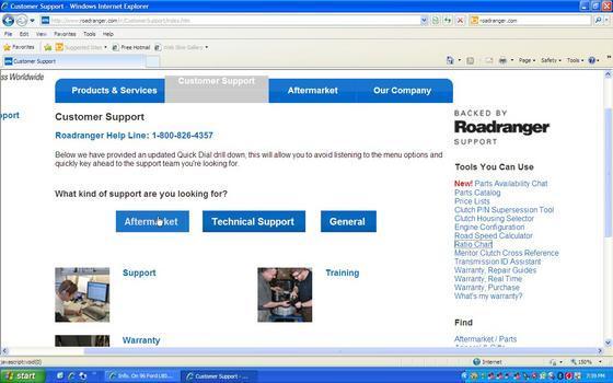

Trans Ratio Chart... .
go to "roadranger.com", hit the "customer support tab" top center.
When you see this screen select "ratio chart" on the right under "tools you can use" and a spreadsheet will load. Pick the 6-speed tab at the bottom and find the FS-6306A. That will show the ratio for each forward gear.
Mike.
