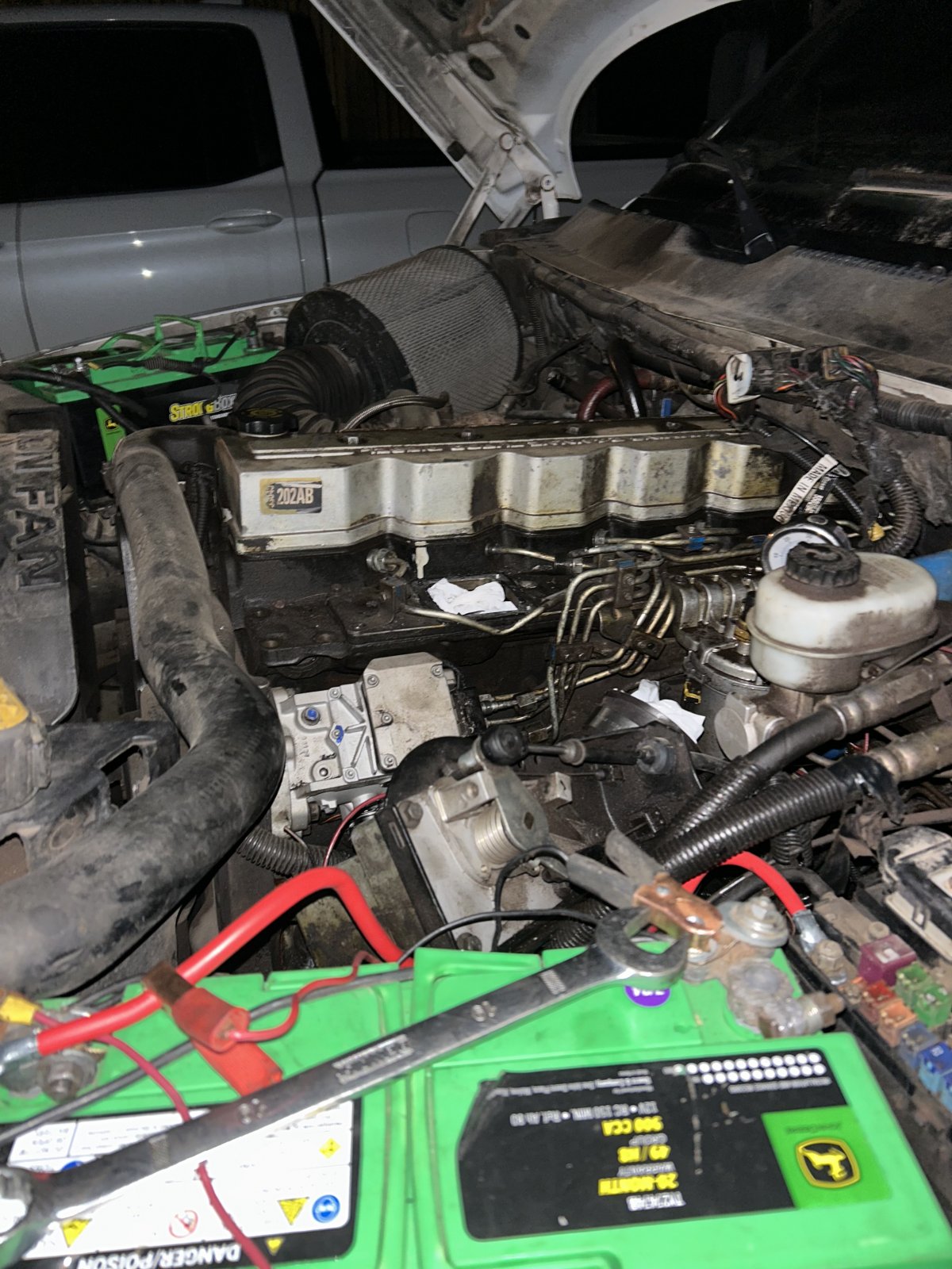

Has anyone ever gotten a bad one ? I thought maybe the injection lines were plugged but I pulled the first set and they are not plugged

I’ve done 5 or 6 of these pumps and never got a bad one yet but I think I finally have a bad one . I have fuel to it and power and ground to the pump thought maybe I was losing one or the other while cranking but that’s not the case . Thought I had plugged fuel lines because I had a dribble of fuel at the pump but more research reveals that not to be the case either . I called the company and all they could say was well did you bleed it ? Does the horn work . Ya I’ve done a bunch of pumps I know how to bleed injectors there isn’t any fuel at the injectors . I was stupider after making the call than before which is a pretty hard thing to achieve and yes Mr phone helpline guy the horn works and I’ve bled on this thing for long I need to replace the starter . I’ve had these be super hard to bleed so figured maybe it still had air in it . And yes I have a fuel pressure gauge and no that isn’t the problem

This is the project that won’t die for sure . I called rhe place I bought the pump from and all he could say was that it was my problem well Mr pump guy I have everything I need to make it run and no fuel to the engine . Now I’m trying to find the credit card receipt to figure out where I got the pump from and when so I can send it back
