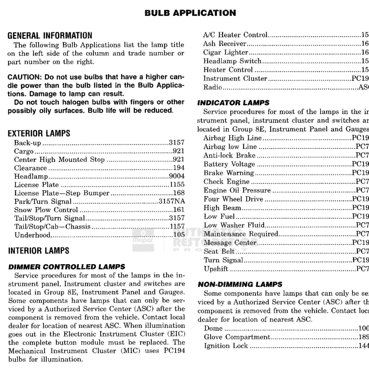

Ya'll, I am trying to replace all the bulbs inside the instrument cluster. I was able to change all of them except the low wash, seat belt, ect. because they were all gone except one base but the bulb was gone. The base that was there is smaller than the ones behind the gauges. Before I brave taking the cluster out again could someone tell me the bulb and base size? Is it the same as the gauges (PC74)?
that’s for a 95
