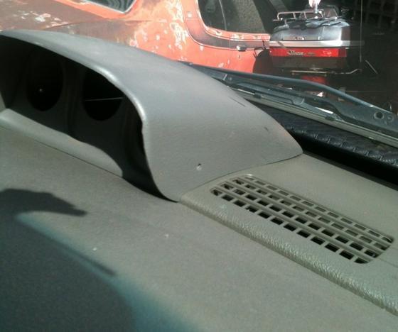

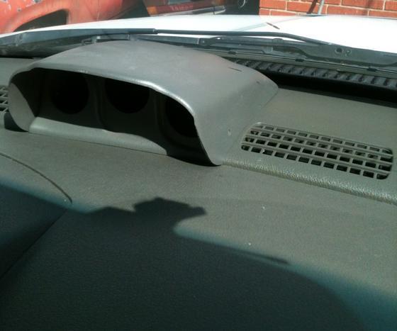

On my 2007 I am installing a 3 gauge mount on the top of the panel. It mounts to the defrost vent cover. I am trying to find the color to paint it to match. Dodge says they don't have a color name or number for it (they said it may be med slate gray). The truck has the khaki interior (-J3)and it appears to be a dark khaki color. However, all the dark khaki I find has a green tint. Can anyone help me with this?
I did the same thing last winter, I took the serial number of truck to dealer and they looked up the color, you could also take the top cover off and find the part number on the bottom side they could look that number up as well and get a paint color. Hope this helps Laurie
I talked to the local dealer and they didn't have a clue how to find the color. It appears to be dark khaki and I have ordered a can of it from them. It is having to come from Detroit and said it may take 2 or 3 weeks. I will see when it gets here how close it is and post my findings. There is a Dodge part number for it.
Here's two pics painted with the 5134797AA paint.
