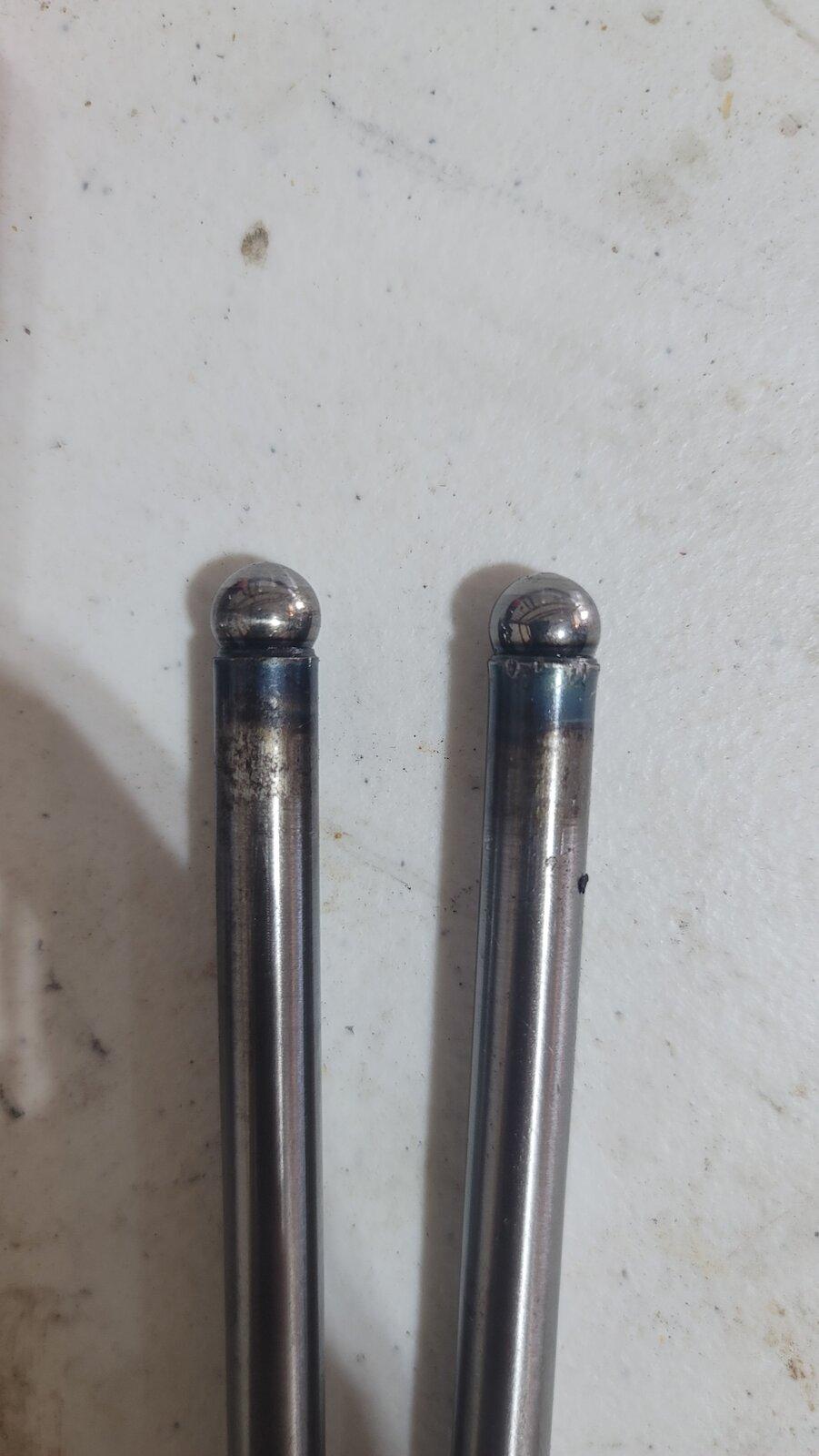

Finally got around to doing this. Think I found the issue. Push rod end is smashed in.
Replaced that pushrod with a new one, reset all valve lash clearance, and I still get that damn thumping noise in the intake air box at idle. I describe it as a fast bouncing basketball. Could it be a noise I'm not used to hearing since the block is sleeved on the #5 cylinder? It's only at idle that I can hear it. It's not as loud when I'm in park but if I put it in reverse or drive it gets louder. It runs and drives great, hold boost at 22-23psi. No smoke at idle and just a little black puff when I really open it up.
