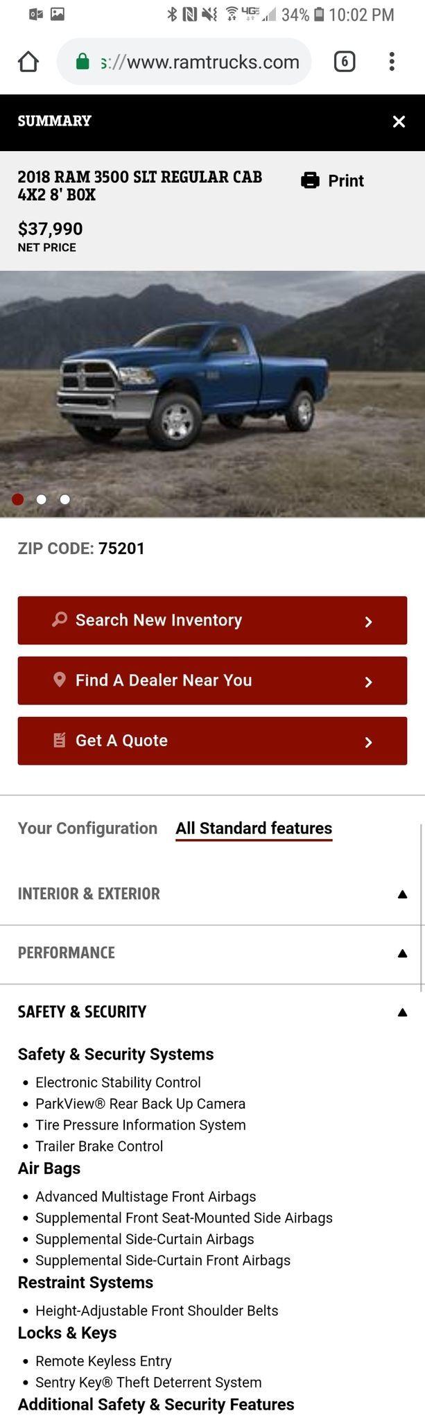

Just purchased a 3500 srw with a cummins and just realized it does not have a brake controller. I cant believe ram would have a 1 ton truck that's made to tow and not make it standard. Now to my question, should I go with a factory installment or aftermarket? I'm assuming the factory installment is just that and it mounts where the controller does when it equipped with one in center dash. Also does this mean my truck does not have the heavy duty cooling system? Thanks

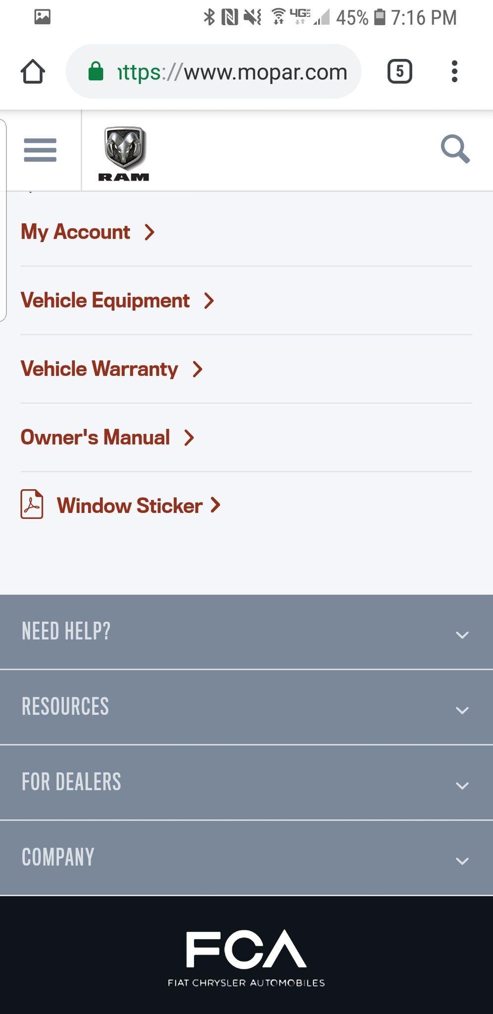

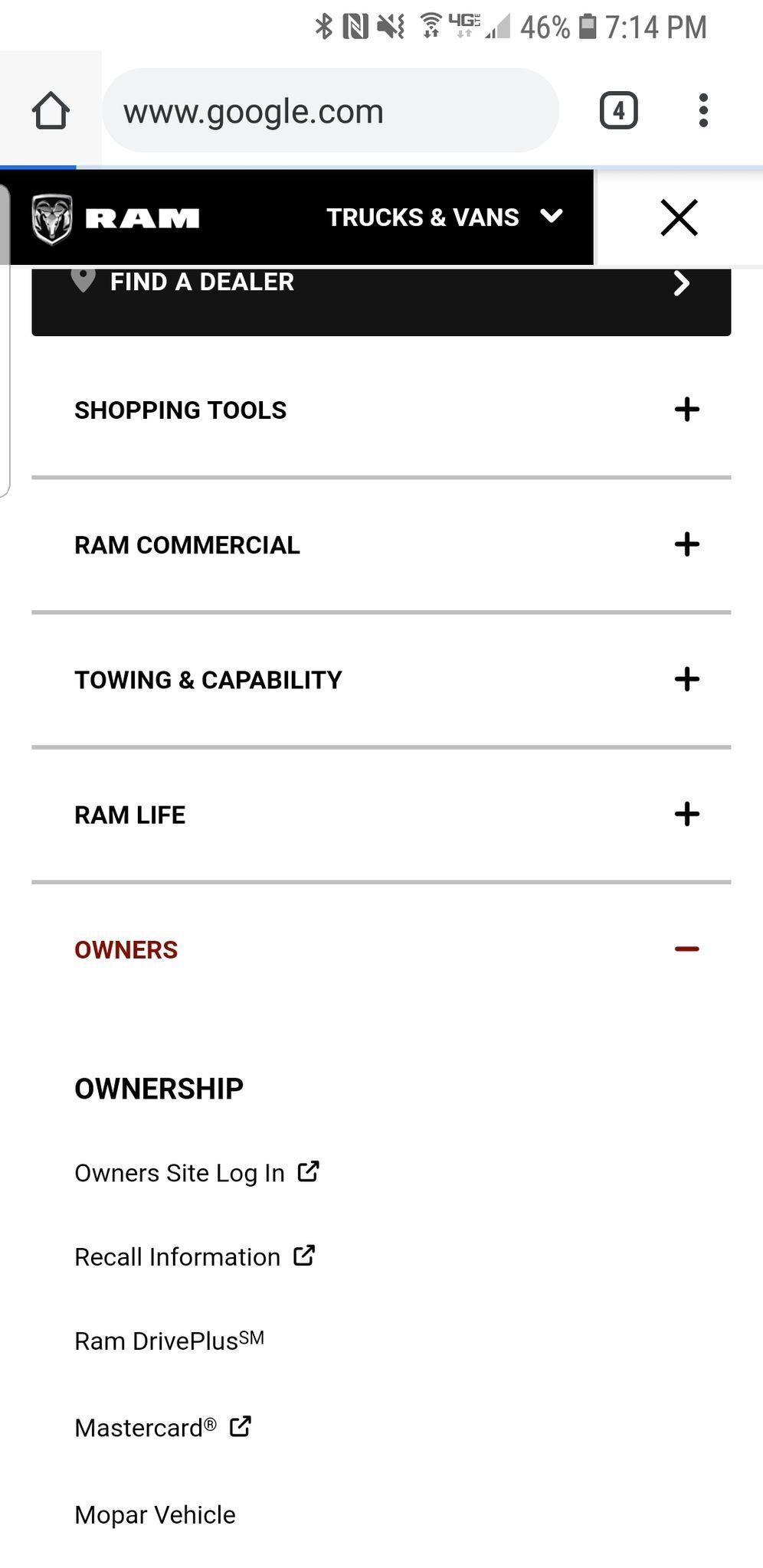

Go to ramtrucks.com goto Menu, then Owners, and register then you can enter your VIN and see a bunch of stuff thats not on the window sticker.

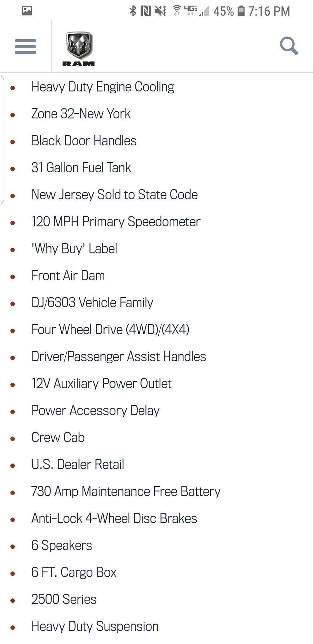

Vehicle Information>
My HD Cooling was under Standard.

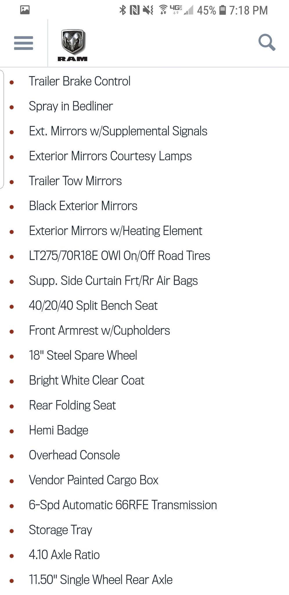

My Trailer Brake Controller was under Options.
It also on my window sticker. You can download that from there as well.
The factory one works well. I can't speak for the after market ones. Price the "Banks" with installation and compare with a dealer installed factory one?
I would have thought a brake controller would be standard on all 3500's. I guess not?

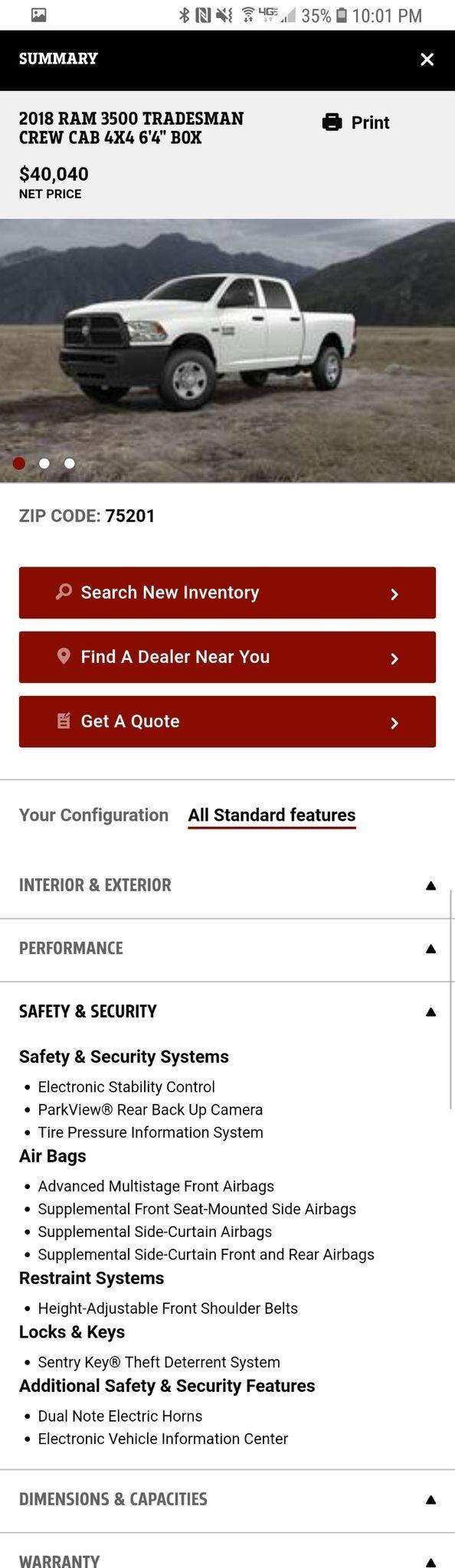

My 2500 has a factory installed one as an option
Tradesman its appears as a $295 option.
SLT and higher it appears in the standard packages under Safety and Security.
