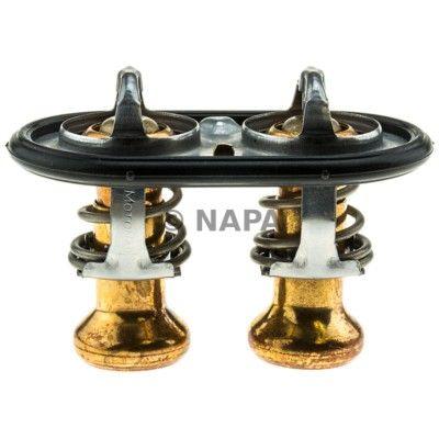

Thanks Wayne, for the Ford lesson 101:) I don't think I would even open the hood if it were mine. The belt is 141" long, that's more than the wheelbase of my '01! Two alternators, two water pumps, power steering pump, fan, crank, A/C and belt tensioner, did I forget any, lol The belt drives on both sides. Two thermostats, one is 201* and one is 194*, not sure which is which.
