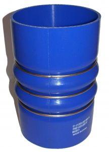

Don't overlook what the truck dealers have as well....Flex Fab makes the air to air boots for a lot of the OEM truck manufacturers and they are blue silicone.
For example a 4" boot with reinforcing rings (the most common one) sells for about $18.00 to $20.00........there are many sizes beyond that.
Part Number for the 4" boot is FLF FRE1020 001.
