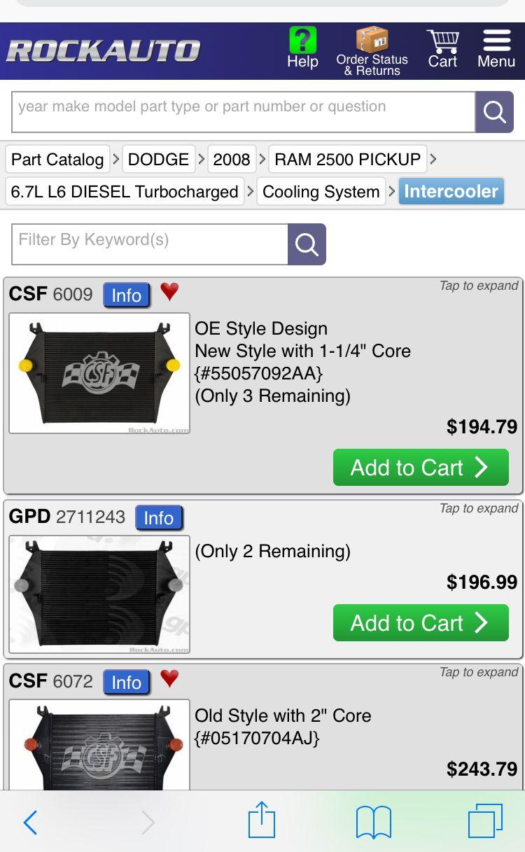

Last year I bought a used 2008 2500HD. it was a front-end wreck repair but things were still tweaked when I got it. this week I removed the new AC core and found the inter-cooler behind it was really smashed in pretty bad. Couldn't believe it was still working. So I need to replace it. I tried 8 wrecking yards....found some other pieces, but no luck with an inter-cooler. Found two sizes on- line, but neither were a match for my inter-coolers core size, which has a 2-3/8" thick core. I could only find 1-1/4" or 2" replacements on-line. Does the Ram 2500 heavy duty model use a bigger core than normal? Also, prices varied from 200$ to almost 2000$ with most around 250-300$ on-line. That's a big spread. Can I just go with a 250$ unit with a 2" core thickness or will I be loosing power with the thinner core. I prefer using OEM parts, so I am wondering if anybody has one of these take-offs that they replaced with some giant after-market cooler on their race truck. Got a trip to Colorado this month, so I need one ASAP. Call me (714) 244-907six

IIRC the intercooler got smaller after a year or two to help reduce the regen frequency. Any of them should fit thou.
If you find one for a 07-09 6.7 it should fit, but the 1 1/4” might help reduce regens and is likely plenty of cooling for a stock 6.7.
Rock auto has 8 to choose from for a ‘08 6.7 2500.
Just drill in as I did on their site, and you’ll see them.
Yeah I was on that site a few days ago. The cheaper Chinese ones, but none are the 2-3/8" core that I have. I know they will fit but are more restrictive and will therefor reduce power a bit.

The smaller intercooler likely won’t reduce power, but it should help the EGR/DPF system out... which is why they went to a smaller IC.

Well, I stepped up and ordered an intercooler; CSF brand with aluminum tanks "old style 2" core" OEM replacement model. Cost 265$ shipped with tax. Have to push the right hand side of the lower support cross bar back about 3/4" to get the new intercooler to go back and match the upper core support cross member. The PO bent lower one forward too far when fixing the collision damage. I think I will have to put the bent intercooler back on so I can drive it enough to push the lower support against a tree, to straighten it. Can't think of another way, out here on the ranch. I got a week to get this back to running for my Colorado trip. Will have to deal with the re-gen thing when I get back. Wish me luck..
