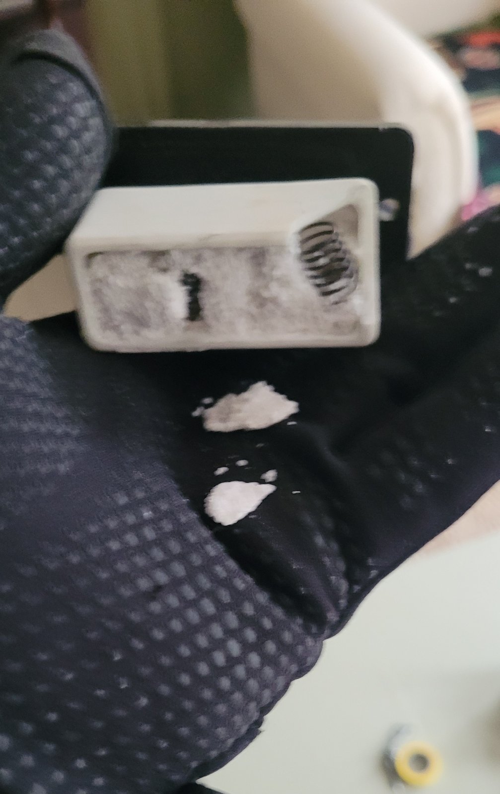

Well. You were right. I swapped the resistor ( the engineer that placed it there needs a good talking to). That did not fix it, even though the resistor was crumbling.

A bad motor (worn/unlubricated/tight bushings) could cause the motor to require more current, in turn overheating and deteriorating the resistor pack.
I found that out with my former 2002 going across the hot desert, AC and fan manually alternated in positions 2, 3 and 4 when 1,2 & 3 quit. Found a NAPA store in the middle of nowhere. Replaced the resistor and all was good. Then the smell of hotness, thought it was due to "oils-n-stuff" during the manufacturing process. A couple hours later pulled over to check the resistor. It was too hot to touch the heater case at the resistor. Pulled resistor and the ceramic was cracked. Put it back in and kept the fan speed low for the remainder of the trip. Ordered a new OEM fan and resistor online. It was delivered to the house and awaiting installation by the time we got home from our vacation. The old motor ran smooth and quiet. However, I forgot the current draw when I tested the new vs. old, but it was "hardly any and warm to the touch resistor pack" amps vs." "a whole lot too many and roast hot dogs in 5 seconds or less" amps.
